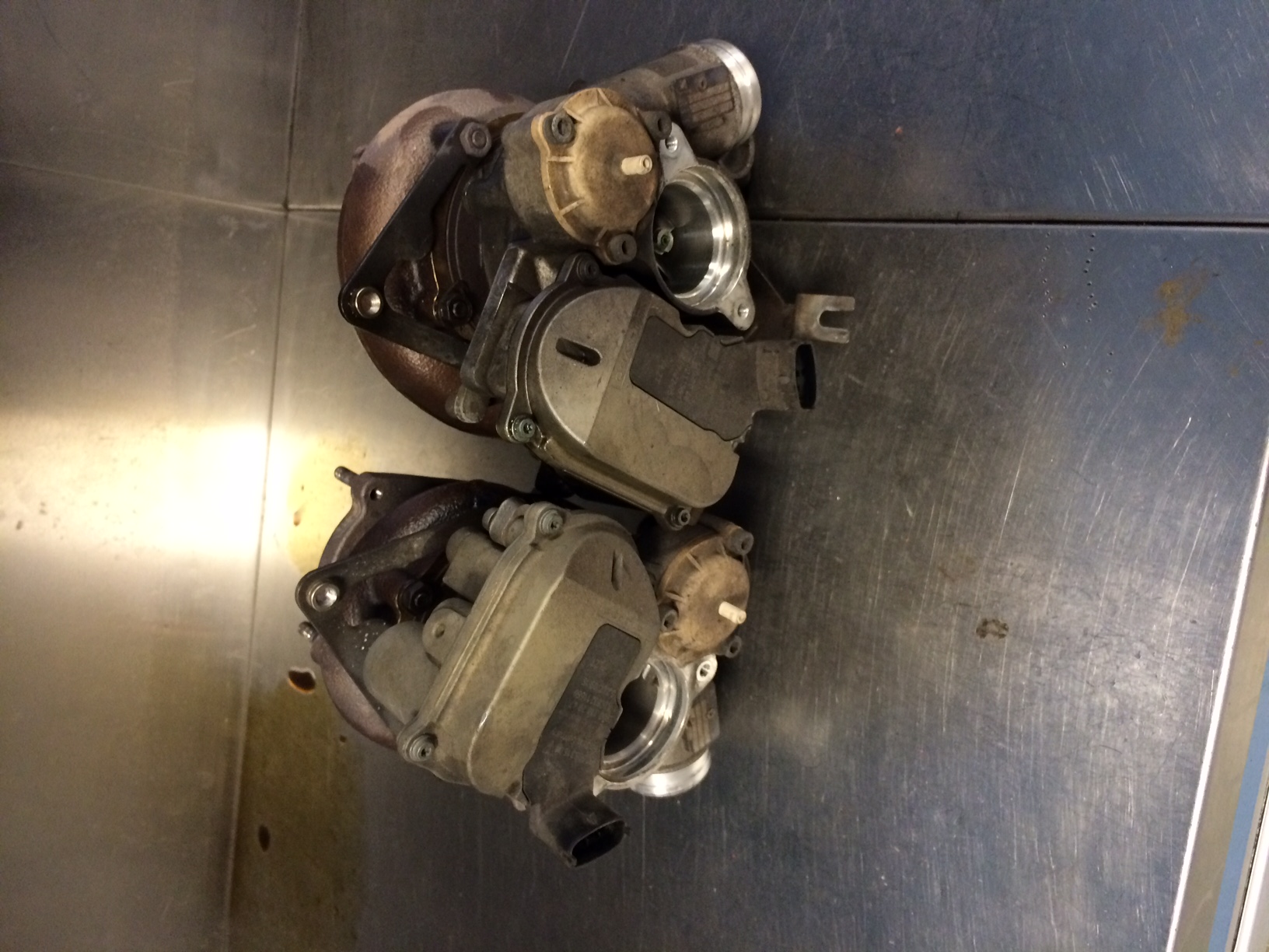

-EVT 775 High Flow VTG Turbochargers w/ 65mm Billet Compressor Wheels

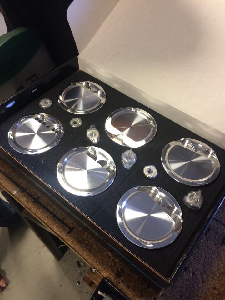

EVOMS 3.8L Piston and Cylinder Kit
-Darton sleeves to accommodate larger pistons
-CP Pistons 102.6mm bore
-Carrillo rods

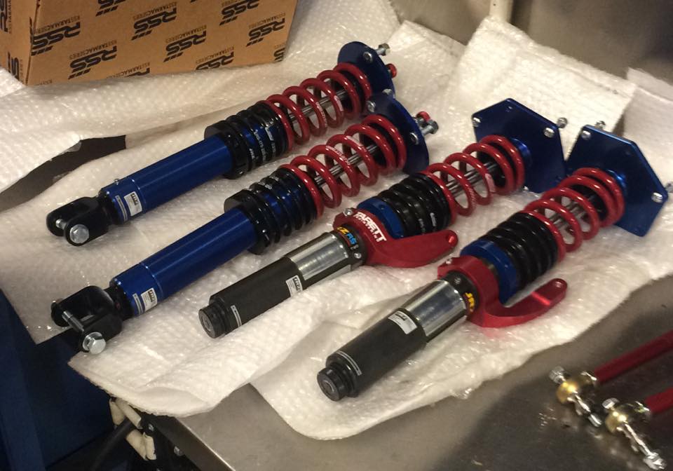

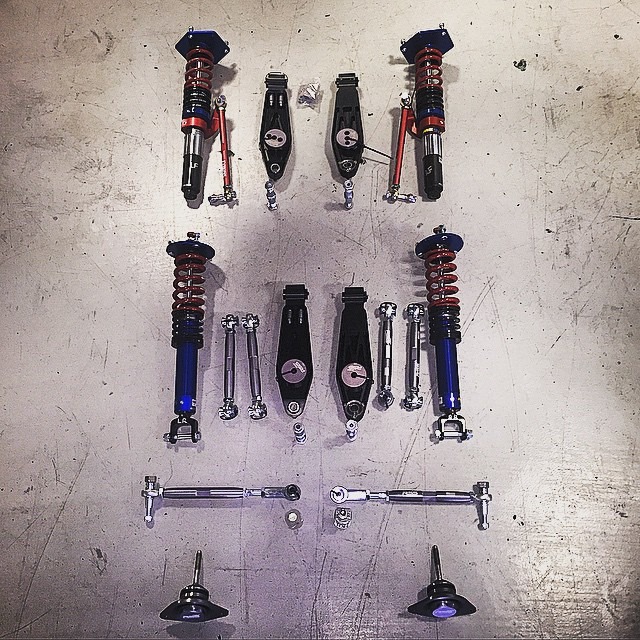

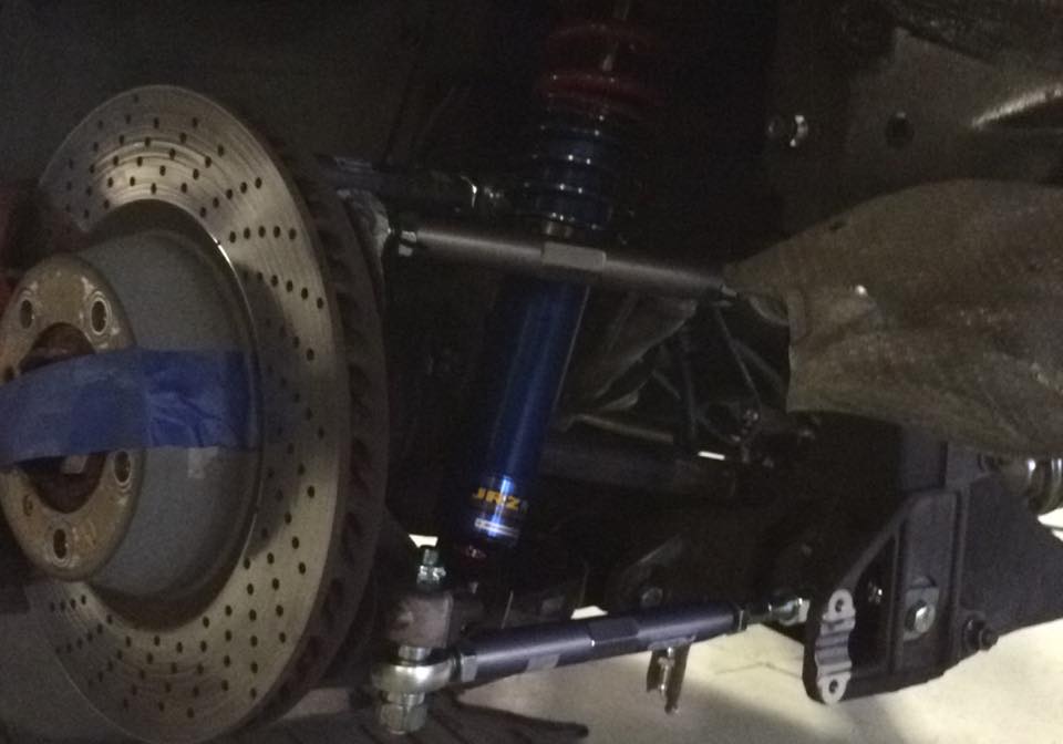

-JRZ RS-Two Dual Adjustable Coil overs
-Brembo Front GT Brake Kit - 380x34mm 6-Piston
-Brembo Rear GT Brake Kit - 380x28mm 4-Piston
-Tarett GT Series 26.8mm 5-way Adjustable Front Sway Bar
-Tarett Adjustable Front Sway Bar Droplinks
-OEM GT3 24mm 3-way Adjustable Rear Sway Bar
-RSS Tarmac Series Lower Control Arms
-RSS Adjustable Toe Steer Kit
-RSS Adjustable Rear Link Kit
-RSS Front Adjustable Toe/Bump Steer Kit

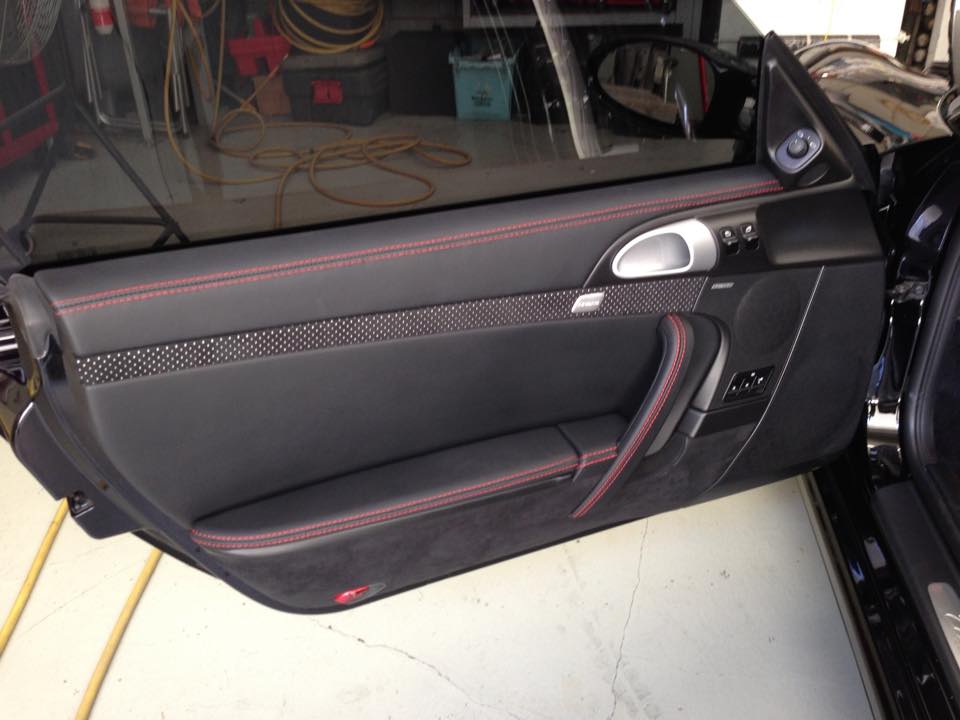

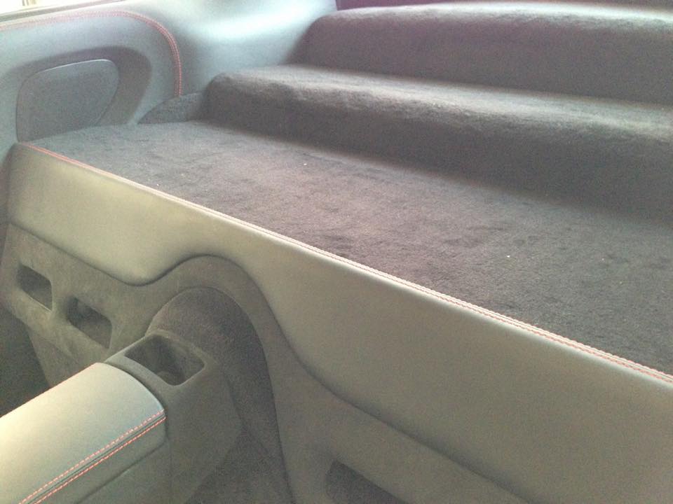

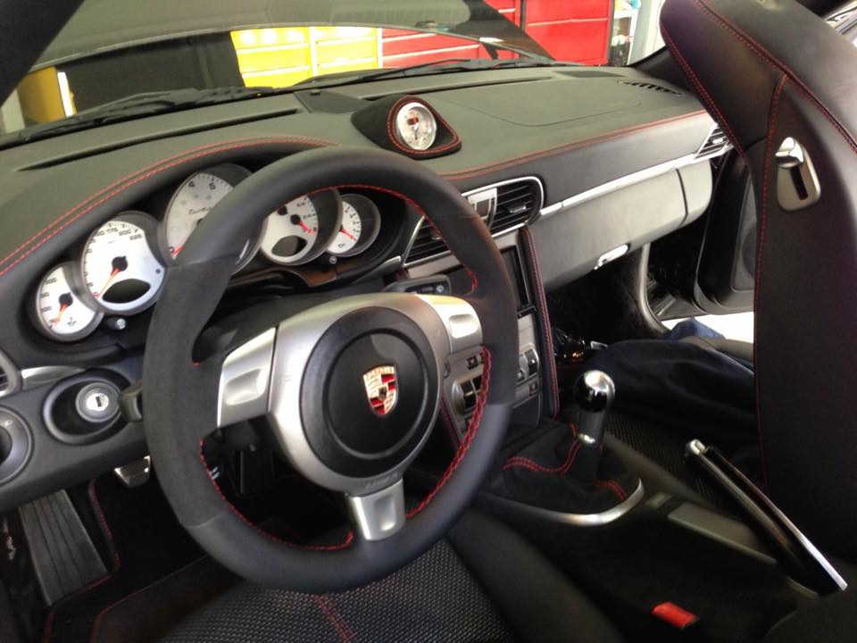

-Redone interior, original was gray. Done by Audio Gallery in LA.
-Focal K2 Power 3 way speakers up front, 3 10'' JL W3 subs in GT2 rear
-Integrated ESCORT PASSPORT 9500ci with display in rearview mirror

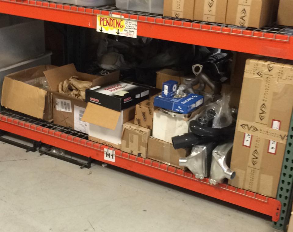

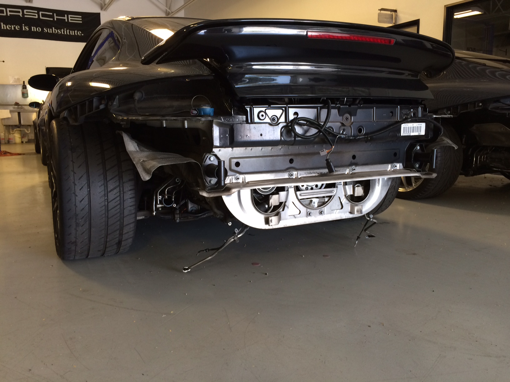

More pics
