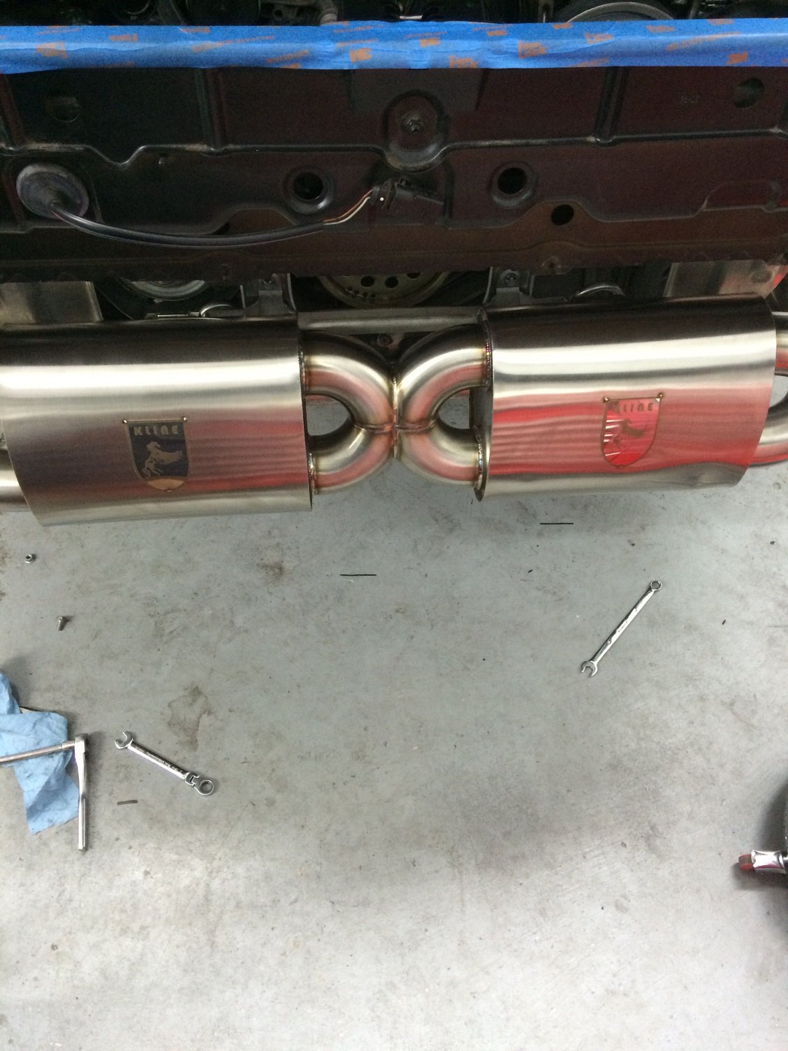

From earlier this week . Motor back and secured on mounts
New Kline exhaust in and sounds awesome. The quality is superb and the fit is perfect! Thanks to SamboTT@by design for the deal as well as advice for easier install :-). This is the type of service we all need to support our habits. It's like having a personal adviser.
Haven't taken it for a spin yet but will do a review and video. Almost done with detailing last minute stuff then remaining stuff goes back on

Just extra precaution on high traffic areas from tools and/or putting stuff back. For example I remove and install the bumper with no help and the sides flap around upon alignment.
