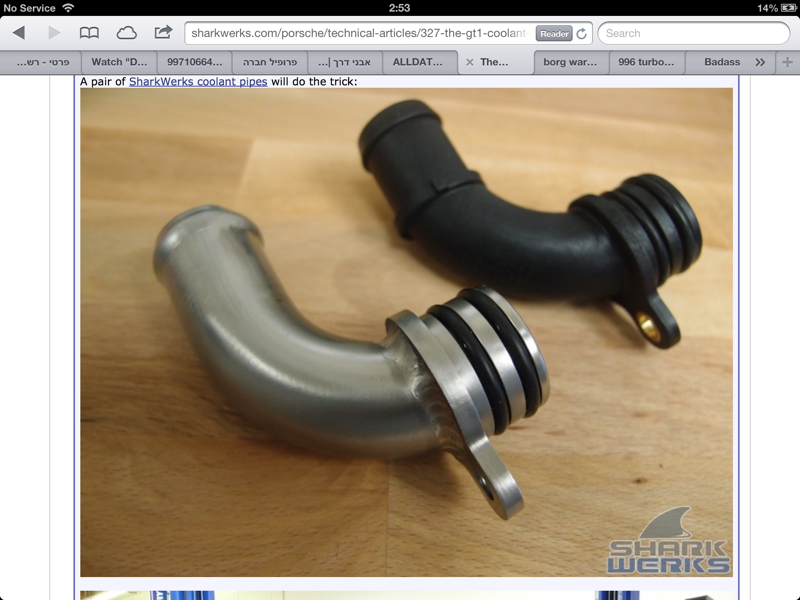

Yea the elbows that feed two lines
Go to the turbos if I remember correctly. There is a set for sale in the classifieds I think prodigy (Marc) has a set he didn't use.

Ron,your the man..
The pics helps and puts every thing in place.Thanks!!

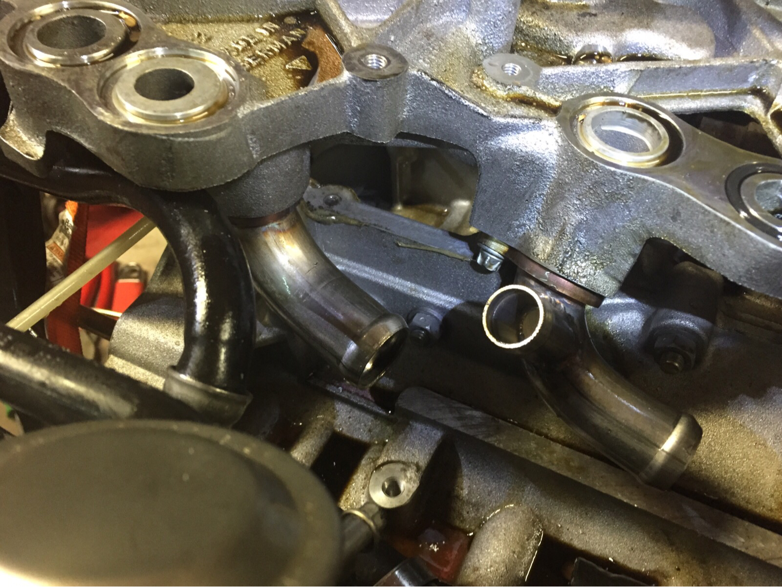

Here's an example (from my car) of a leak at one of the elbows off the oil cooler that was not evident at all until the engine was dropped. It has clearly been leaking for a long time, just not enough to be visible with the engine in place. All three had been leaking to some degree.
One coolant pipe had also started leaking, and another slipped out of the casing when touched after the engine was dropped.

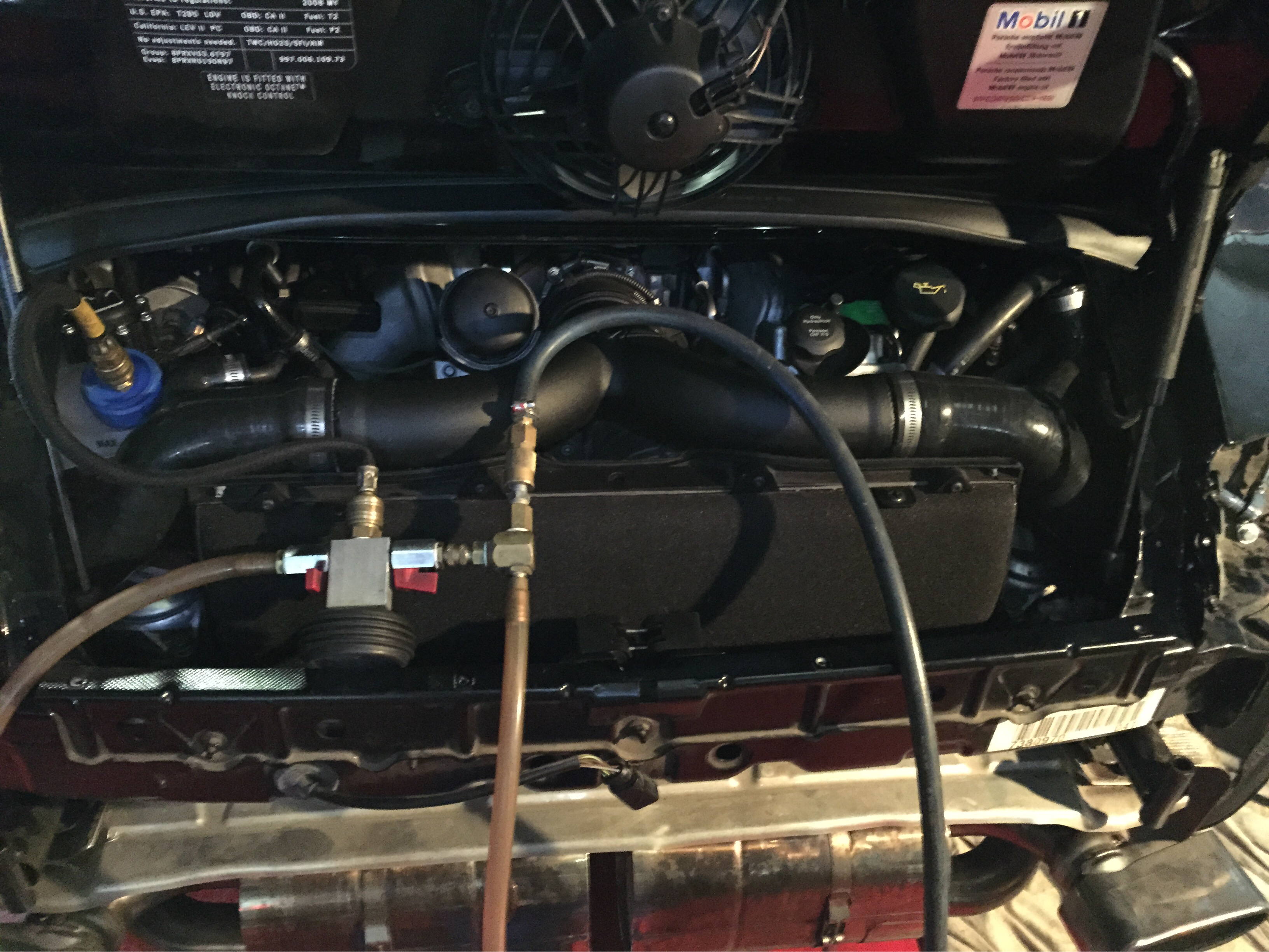

I'm a student of this platform. It's something I love to learn about and someday hope to learn as much as some around here have forgotten.
Something to think about is applying no more than 10-12 psi to the coolant system while your in there with your scope and you'll be able to hear it and see it.
I'm pulling vacuum here I pull the coolant through the system. When putting the engine back into the car do this test prior to buttoning it all back together as to remedy any fitting that didn't get the proper attention.
