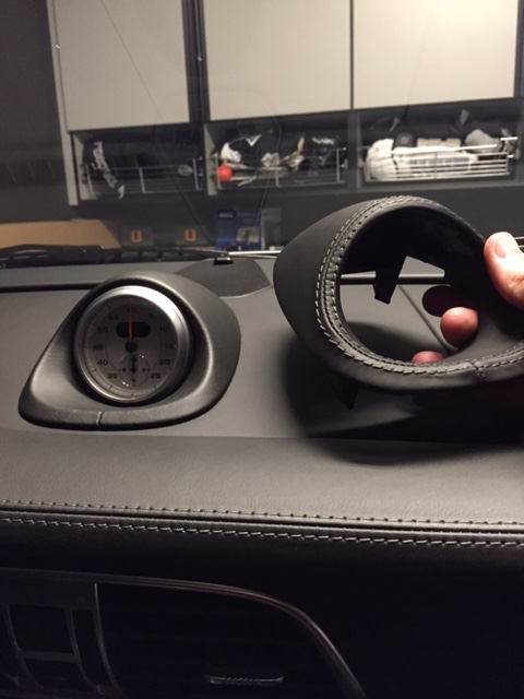

Does anyone in the socal area have experience doing this? I want to remove my OEM chrono pod for an "exclusive option" deviated-stitched substitute... but I'm having a heck of a time removing it carefully, making sure not to damage the dash at all.

Thanks Rock, I should have mentioned that I've seen these instructions before. I'm stuck on step 1.
fwiw, in addition to these instructions, I was told to wrap the removal tool in a microfiber towel and pull "up" on the chrono pod while prying. I've tried, but it doesn't want to budge.

If you look at Macarbon's pix, you will notice 3 attached points on the pod. Use the angled plastic trim removal too and place it under those points, while placing a microfiber towel beneath the tool to minimize any potential indentations to the leather dash surface. You will need to put a little more force into it to make it pop off. Just a gradual but determined prying force, and it will pop off. Very doable.

I've had mine off a few times. Use a bigger pry tool. The indentations (if any) will go away, and you don't feel like you're straining to release the clips. Don't pull. Pry! Good luck.

i literally used a spatula and some masking tape... Worked fine, no dents in the dash.
