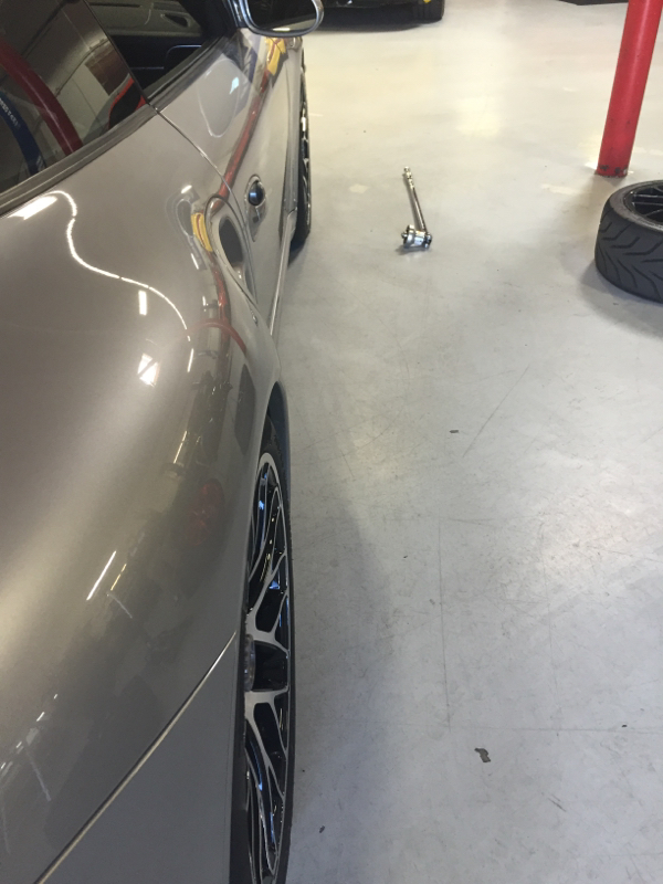

My stock 19" centerlocks have R888's for racing so I'm thinking about another wheel/tire combo to put on just for driving around town. Can the centerlocks from the 991 Turbo or 991 GTS fit the 997 Turbo? I would definitely have them painted black as I'm not thrilled about the chrome/black look. Thanks! EDIT: GMG had an extra set lying around and installed them for me this morning. They fit almost EXACTLY the same as the stock 997.2 centerlocks. The front wheel was nearly flush with the fender but the rear was set in about an inch, which I do not like. Here's pics:

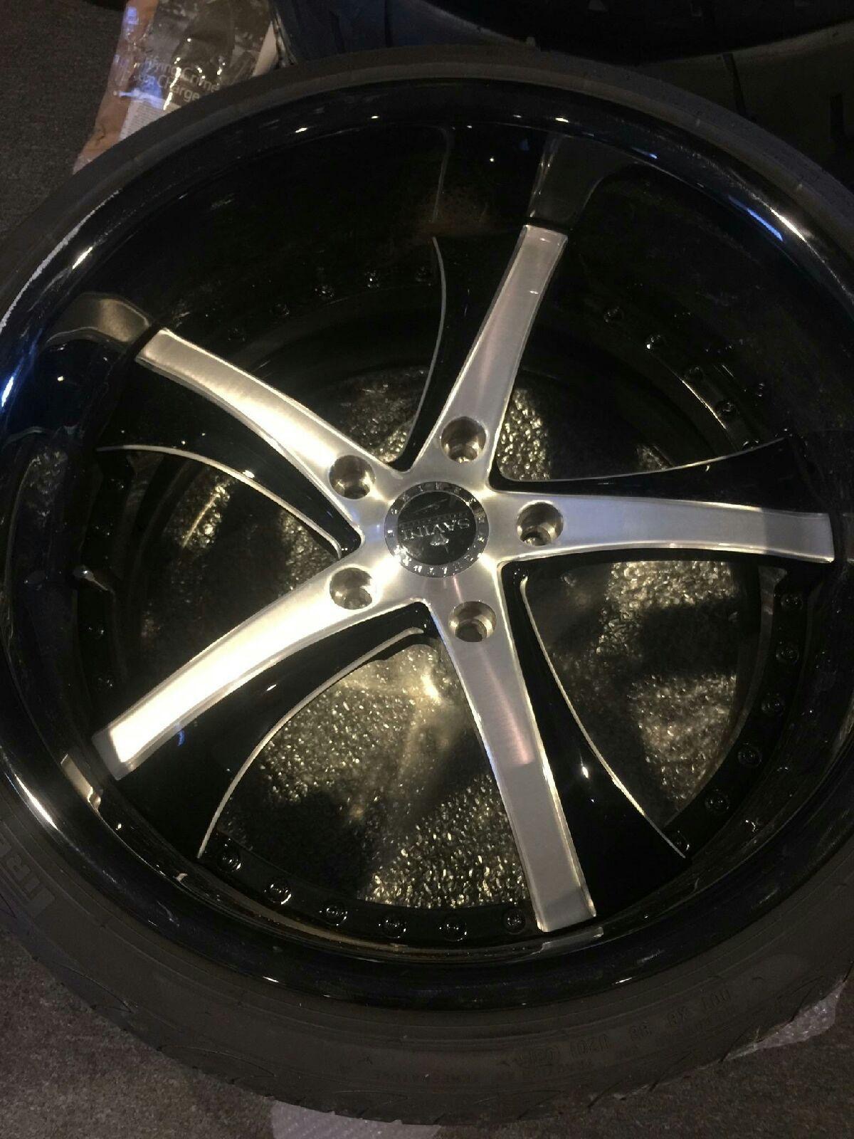

can you run lug bolts? i have a friend with a set of 20" savini wheels with brand new tires he is selling less than 100 miles 245 front 305 rears.

Nah can only run centerlocks. If the 991 Turbo centerlocks don't fit I've been set on HRE P101's for a while.

So does that mean the 991 wheels will not sit flush? Instead they will be set in too far? You are right, we cannot use spacers.

Yep, they will be in too far. Out of my own curiosity I checked. Weird, but the turbo wheels have offsets of 56 and the GTS wheels have offsets of 52. So the GTS wheels should work, but won't be very aggressive and the turbo wheels could work if they don't create inboard clearance issues. Neither will have a very aggressive look and you can't fix it with spacers.

Stock rear offsets are 51mm, but everyone always wants to go more aggressive ;-) .
