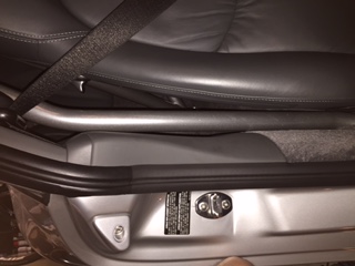

I picked up a 997 GMG World Challenge bar as it offered (quoting from GMG's site) - "Designed to work standard reclining seats or GT3 fixed back seats offering drivers the ability to move the seat all the way back (Not possible with the factory Tequipment Rollbar) " Perhaps "standard" means non-sport adaptive, which could be the issue here? However, I am not sure if the standard seats have a thinner base & backing in comparison.
While I am familiar with the limitations of the tequipment bar, this statement as I interpreted it is false.
The factory seat is unable to move all the way back, in fact, I've lost a good 4-5" of movement, forcing my knees to touch the steering wheel unless i move it as close as possible to myself and in the highest upright position.
I am 6'3" and I do not have a problem fitting in factory sport seats without the bar, in fact, it'm quote comfortable in the car without it. However, after going through the torture of installing it myself, it's really ruined the ride for me as I am not even comfortable in the car and safety is compromised because if my foot is on the clutch (depressed) during a turn, my hands hit my knees, making it difficult to turn.
I also tried a Recaro SPG-XL on Brey Krause sliders and had EVEN LESS ROOM!
My next option is to try a Brey Krause floor mount and see if that makes any difference with a Recaro Seat. If this doesn't fit it, I'll be removing the bar as it's made the ride unsafe and uncomfortable.
Has anyone experience something similar with the GMG WC / WC-GT bars?
Happy Holidays!
Loss of room, pictured for reference.

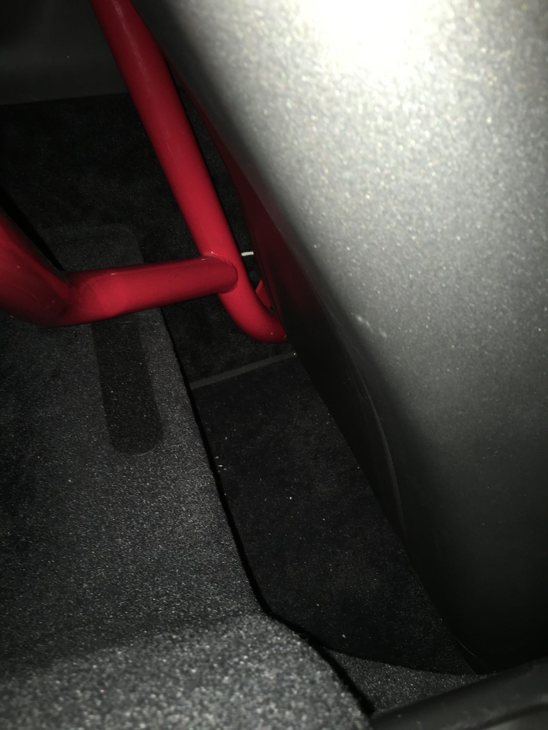

This is only the case with the LMS bar, correct? The seat belt mounts on the WCGT interfere with rearward seat movement. Would you be able to provide a pic of the seatbelt mount in relation to your seat with the LMS bar? I would really appreciate it.

as for the seat belt mounts, heres every bar omg makes. it appears (and i could be wrong ) that they all share the same front geometry but differ in front bracing that can be added and /or the mounting point off the rear mounts either shock tower mount or seat belt mount hole.
the angle of each front downtime appears to be the same regardless of the bar. to much angle it will collapse to little angle to won't meet up with the hole
https://www.gmgracing.com/store/inde.../interior.html
i had a gmg world challenge bar in randys old 996 turbo and it would not allow full seat slide either. i have a a/p racing rear cage with removable front horizontal and diagonal braces and its the same thing. bottom edge of the seat will hit the bar before full rearward movement

I stand corrected upon further inspection. The stock seats lower plastic trim actually touches the lower front bar mount for the last 1/4" of seat travel only - slight rub, but does not inhibit movement. I would highly recommend getting GMG to install as very difficult and does require small amount of trimming contrary to website description. See attached photos.
