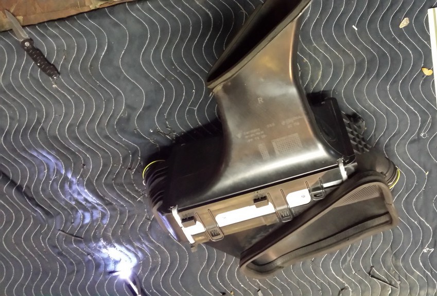

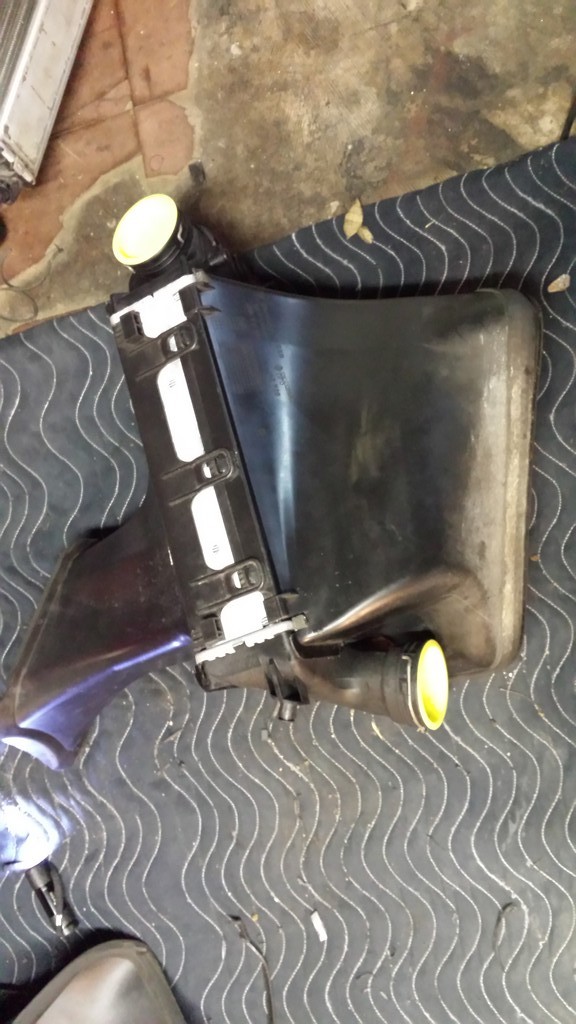

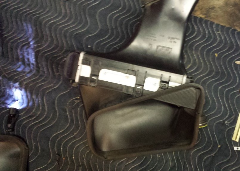

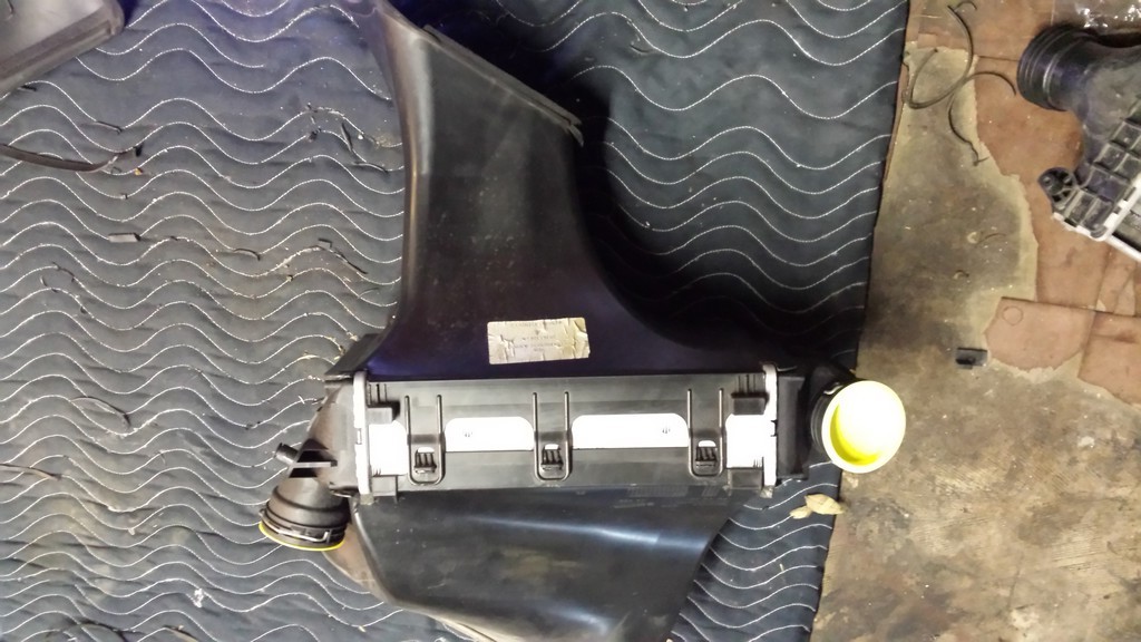

I took some time off this week and decided to install my GT2RS intercoolers. I had purchased these almost a year ago but just now got around to putting them on. I had decided a while back that I wanted to a more OEM-type install, and didn’t want to use the tie-wrap solution.
Let me first say this was a lot of work, not sure I would do this again if I had to do it over.. A fellow forum member sent me some pictures of how he did it which helped greatly. I had to trim the extra “tabs” on the intercoolers so it would fit with the OEM straps. Thankfully it’s aluminum and bends fairly easily, as I took my time so as to not deform the outer row of fins.
Trimming the ducts was slow and tedious, but the pictures I got helped me get started. Definitely a more factory look, but I think I’d rather change my plugs again than do this mod over again
Got it put back together and pressure tested to 22psi using my boost leak tester.
The weather here won’t be cooperating for a few days so it’ll probably be next week before I get to drive it. I plan to schedule a session on a Dyno Dynamics AWD dyno so I can get some readings pre and post my FVD tune..
A couple of pics of the assembled coolers..

Looks good. I'm also looking into this upgrade. Do you have a tune?

Yeah, I've got an FVD tune.

Clean Install Saabin! Great Job!
I think this intercooler option is a great option for the money. I would only beware of its usage if you decide on tracking your car. I wouldn't have burned mine up if I just street drove my car.

That looks factory Saabin... Are you sure you put in bigger intercoolers? .

You did a nice job! I think you will notice and appreciate the difference in the cooler IAT's and quicker recovery when they do heat up...

Nice job getting the factory tabs to fit back. I just used the zip tie method, haha.

that looks stock!
i know of one guy running 65mm turbos making 800 with 997.2 IC's no blowup... yet
