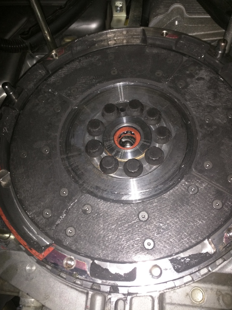

I'm am by no means an expert. i have been in seans car and at 1000 hp he drives it like he is at the drag strip at every light! haven't seen the tilton slip our give him any issues other than quick wear due to driving style. i have a erp in mine but am definitely nervous after the recent threads and issues. time will tell
Hopefully yours stays together better than this one.

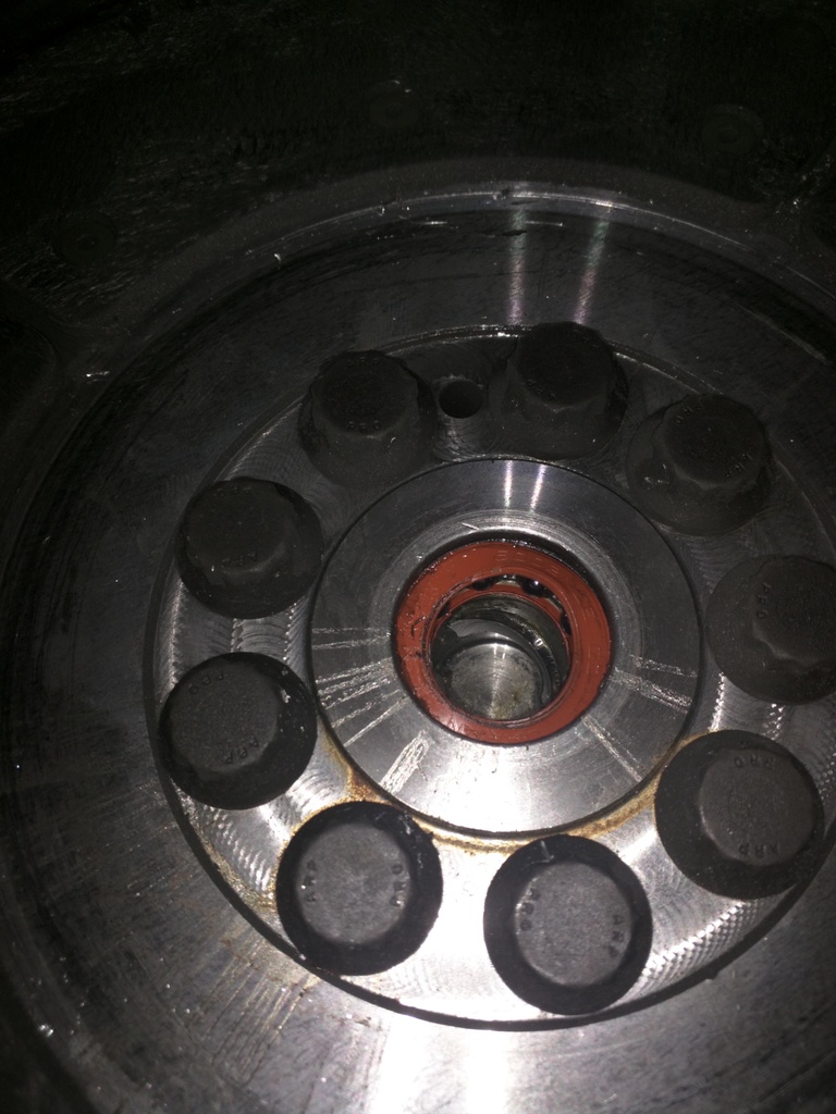

that is the one from the Middle East.
They stay together. The only one that gave out legit was BHTs after tons and tons of beatings. This clutch you posted a picture of broke because of a pilot bearing that went out and went thru it ..... Not because "they come apart" Here are a few more pictures Name:  AF385926-A5BD-4E36-AFF9-562A8E6A0D3B_zpsifpnhzhx.jpg

Old Jan 11, 2016 | 02:34 AM
  #44
rix's Avatar
rix
Joined: Mar 2011
Posts: 1,077
From: Dallas, TX
Rep Power: 174
rix Is a GOD !rix Is a GOD !rix Is a GOD !rix Is a GOD !rix Is a GOD !rix Is a GOD !rix Is a GOD !rix Is a GOD !rix Is a GOD !rix Is a GOD !rix Is a GOD !
I hope not. I have a brand new one ready to go into my car. I thought about trading up to the Tilton but was recommended by EVOMS to stick with the ERP. John B. knows what he's doing so I'll take that on faith.
