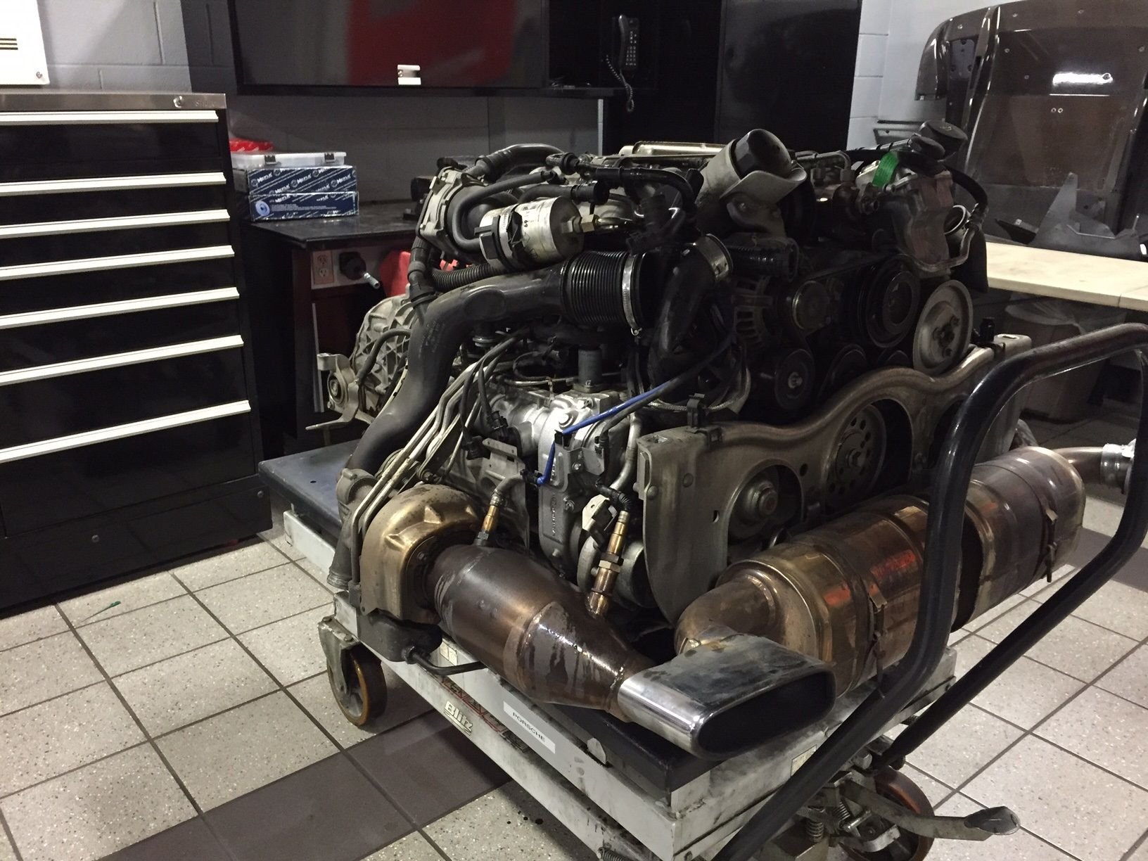

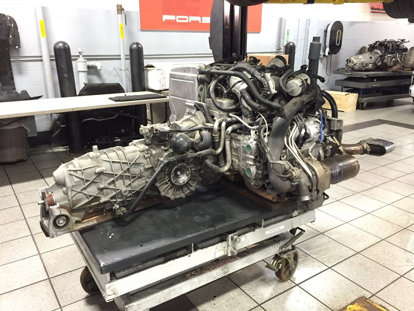

Started by removing the engine

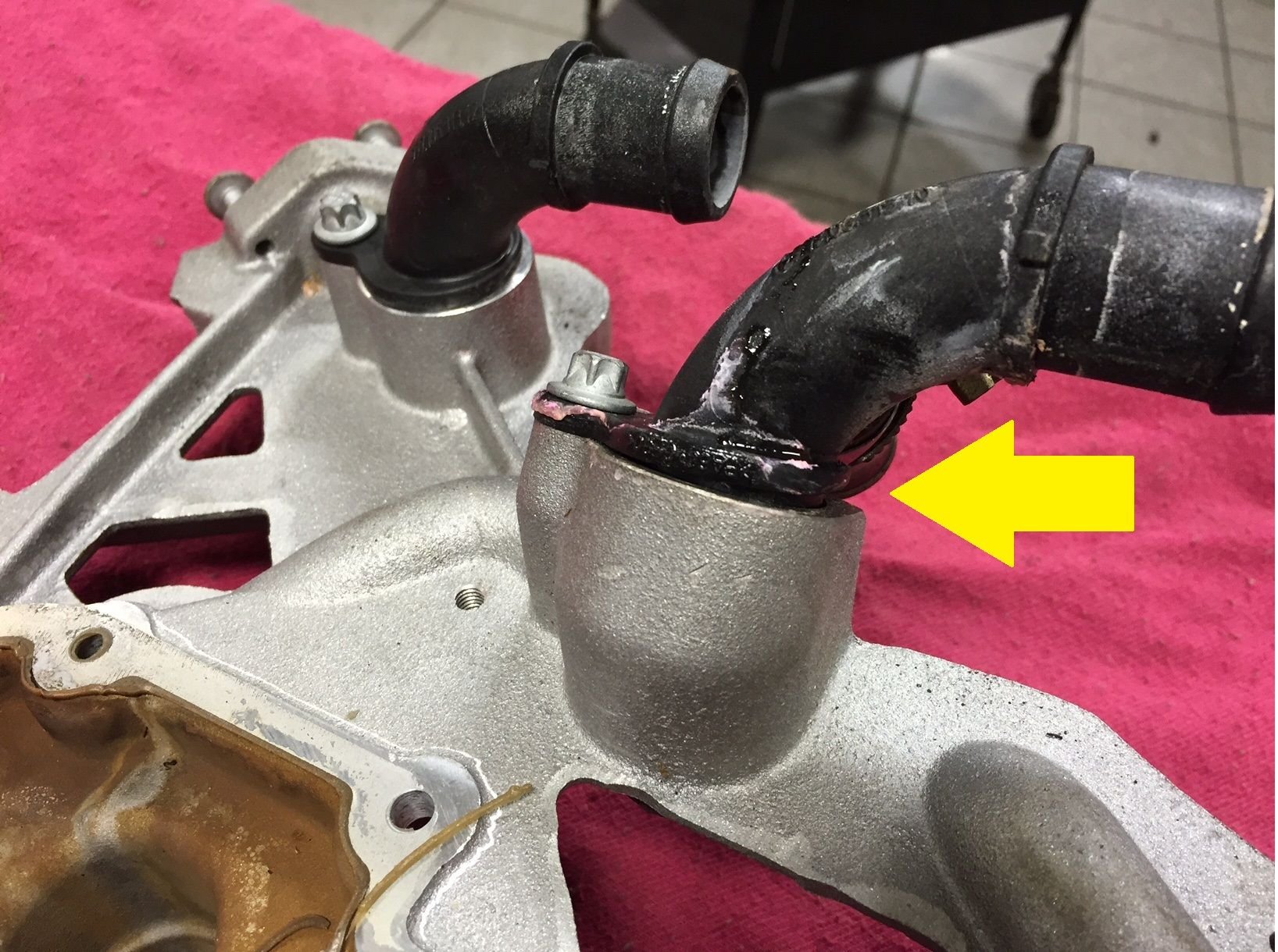

Then after removing all the accessories and intake manifold parts you can remove the oil cooler manifold. It bolts directly to the top of the engine and has plastic coolant pipes underneath it that fail
The failed pipe on this specific 997 turbo

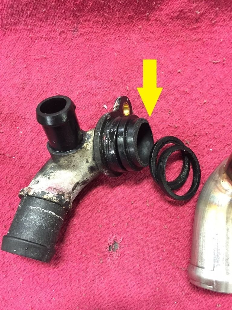

Photo of the shoulded that broke on the failed pipe
Side by side of the original plastic pipes and the Sharkwerks Stainless Steel replacements
