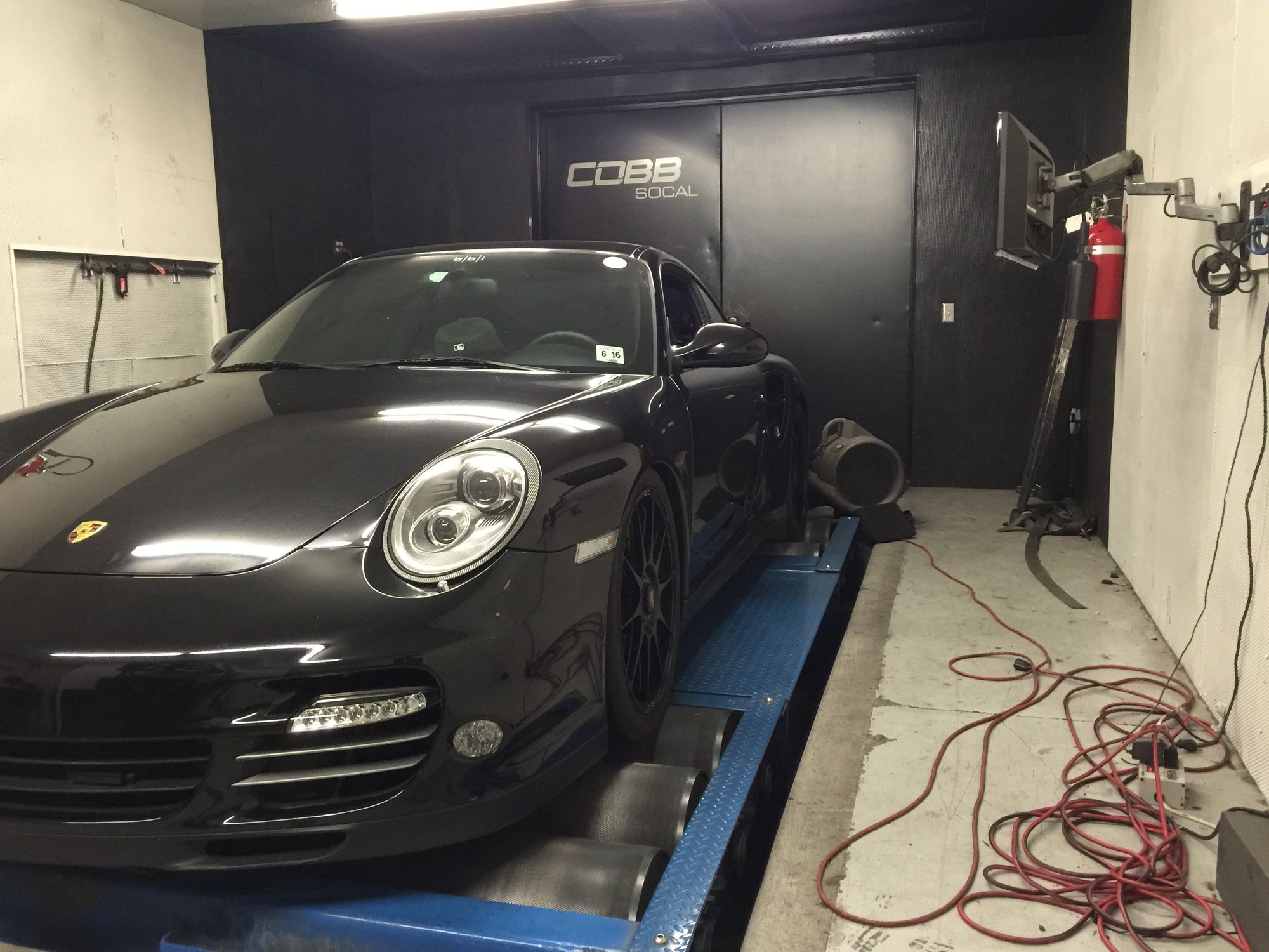

It's been a long time coming, but Mitch, Jon, and the COBB crew were able to get my car on the dyno to tune it after the recent build by BBi.
Mods are:
-COBB AP custom tuned by Mitch McKee
-Xona rotor turbos with custom lines done by BBi
-BBi inconel headers and catless exhaust
-AMS intercooler kit
-Meth injection
-Ipd plenum
-Fueling upgrade COBB/BBi collaboration
-stock motor and pdk

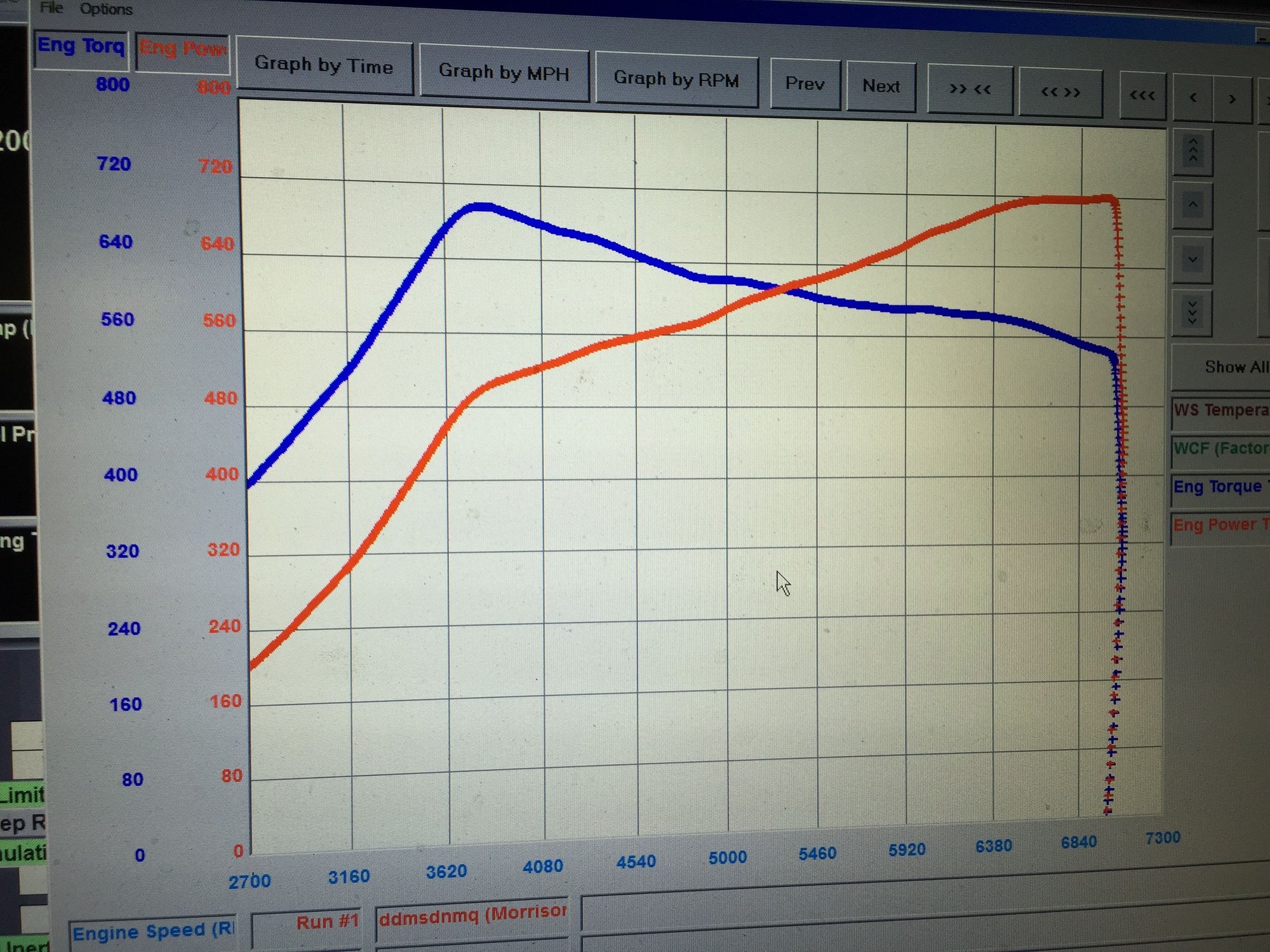

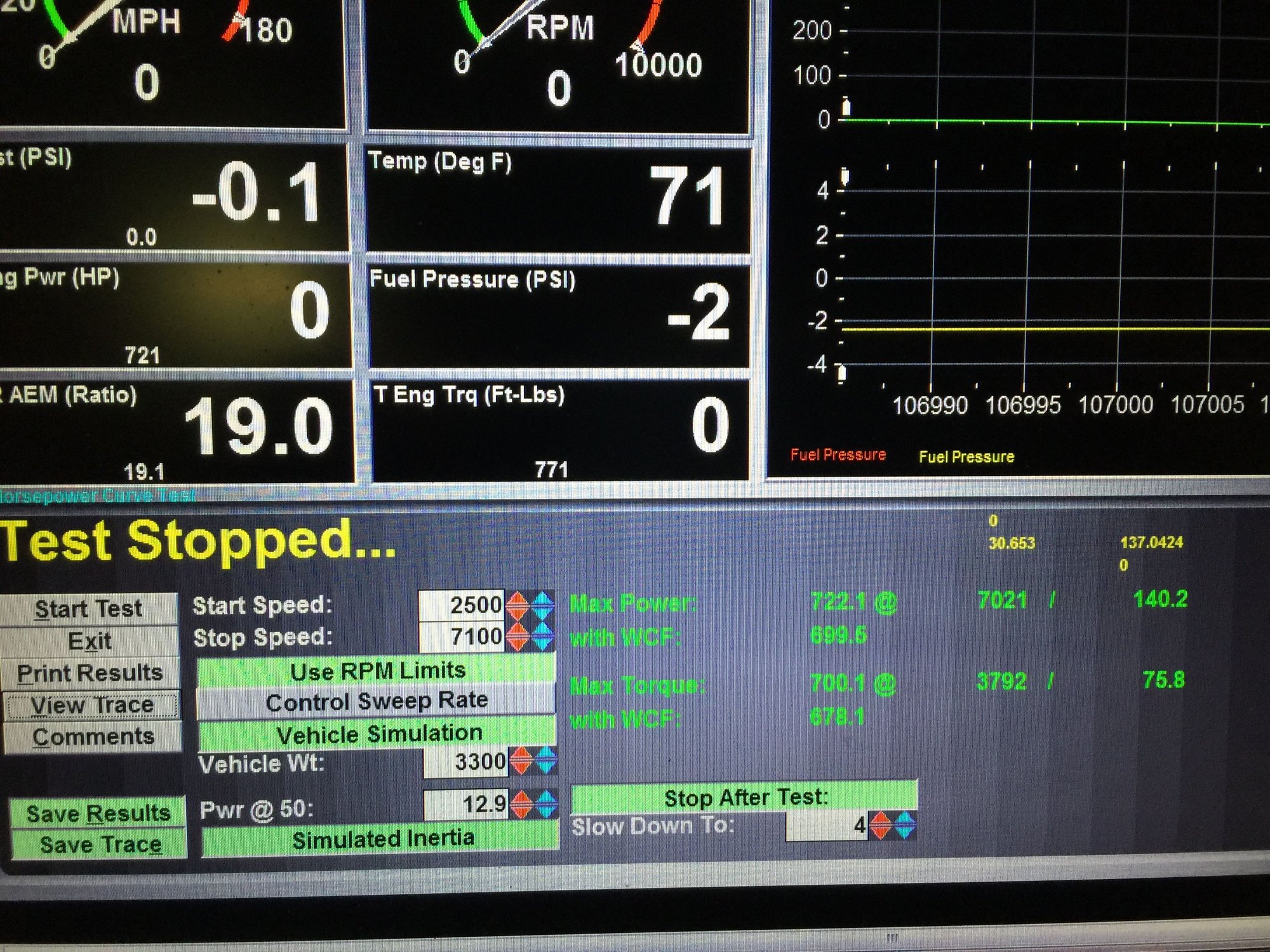

For those wondering about the fuel upgrade, it will support OEM vtgs through medium size standard turbos.
Mitch may chime in but the car made substantially more power but boost came hard and steady so the torque also ramped up. BBi will be switching out the boost controller for a rpm progressive style so we can control the onset of torque to keep the motor happy and safe. The car will be retuned early next week with a goal of near 800 whp with torque in check. I will update this thread with progress.
No pdk slipping and plenty of room with fuel all the way up to (I believe) 750 whp
I cannot put into words how excited I am to get the car back. I'm also beyond happy with the work BBi and COBB did with the car. It's a beast.
A motor build will be in the future to take full advantage of the available power. For now going to enjoy the new power through this upcoming season. Can't wait to put some serious numbers down!

Pretty excited. This is over 80 whp from the tune that went 9.9@138. Possibly a little more to go
