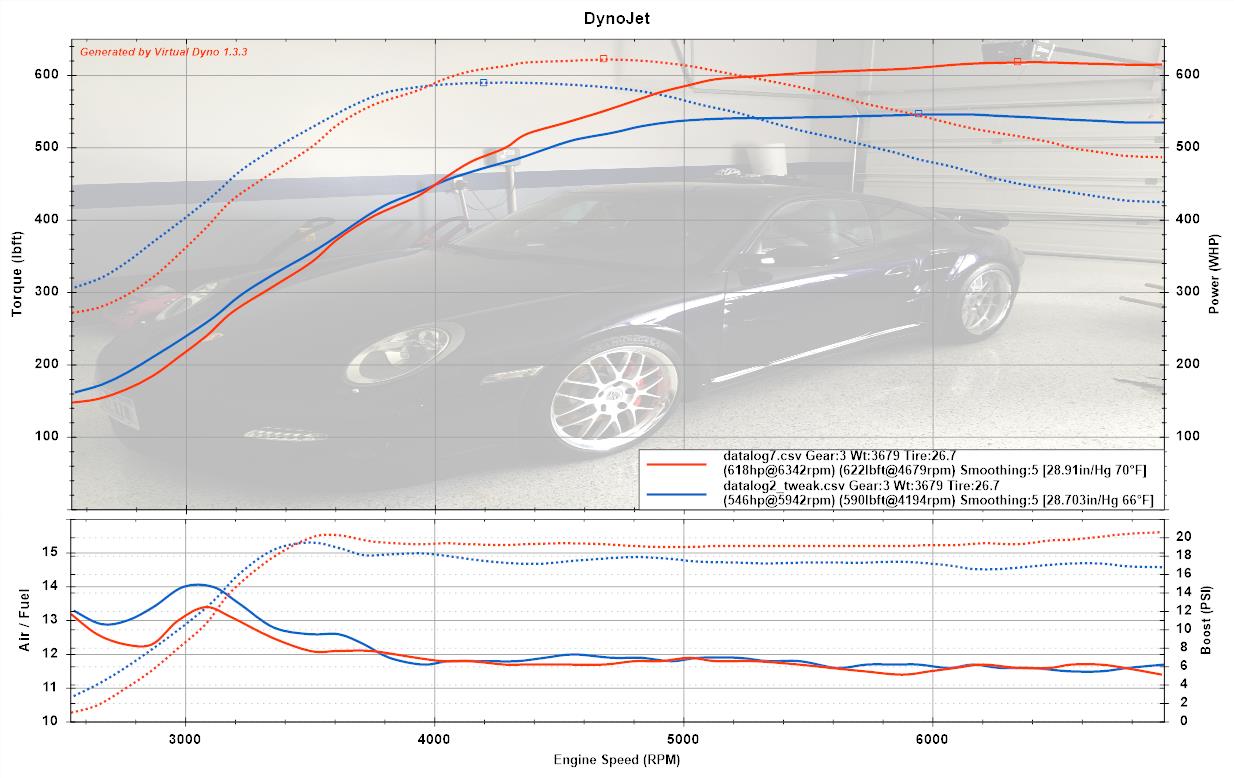

Here are the results using the Virtual Dyno software (free download) with the best specs I could find on the car for simulation. If anyone needs what assumptions I used I could provide them. Results also match a few runs I tried on the Cobb AP dyno app.
The chart is comparing the final calibration on 93oct vs. E85(E70 locally). Based on what I have seen other cars do its running right in line. Sam told me we could get ~600whp conservatively and reliably, I believe he has helped me achieve it. Between him and advice from other members the recipe came together fairly easy. Thanks to everyone who provided input.
How accurate is the software? Multiple articles out there on it. Like any simulation, garbage in garbage out. I would recommend using this as a measuring stick to keep tabs on your car and do comparisons over time and mods. Not bet the farm on it lol.
Enjoy!

Such a cool software. Look at those curves! I bet if you put it on the rollers it would look just about like that exactly. I really am happy the way it turned out and would sleep perfectly at night knowing you can nail that car at any RPM in any condition at any speed as long as you own it! We could get a little more but to me this is a great level and it will perform very well consistently. Congrats pal!
