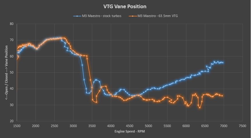

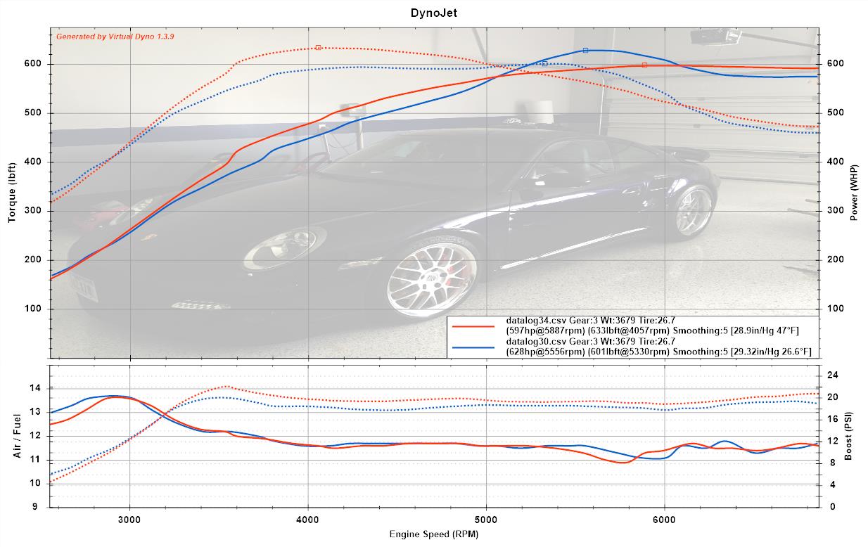

Ended up plotting some early data while calibrating the 93oct file using the Virtual Dyno software I used last year to compare the gains of the 63.5mm vtg upgrade. Used the same settings, same road, and all the data is in SAE format.
The first plot is the 63.5mm VTGs on 93oct, Sam is still dialing in the car in the 5.5krpm thru 6.5krpm range. We would expect that area to smooth out. Hopefully we will have the 93oct file done soon because I really want to move on to E85 .
The second plot was an average of how the car ran last year on the stock turbos with 93oct and E85. Most of the gains here are in the reduction of pumping work. Since the larger compressors are not in choke the vanes run more open. Less pumping work, less residual EGR, and better BSFC.
Third plot is vane position just to help illustrate the difference in position at similar boost pressures.
Don't get too caught up in the absolute number and supposedly what power the car is putting down. I personally use the Virtual Dyno more as a comparison tool. Many articles out there on this tool, it can be very accurate when used correctly.

I use my Cobb datalogging feature, vane position comes in as turbo duty cycle. You will see bank 1 and bank 2. I just use bank 1 for consistency, you can also average both sides, just be consistent. I'm assuming you can pull the same channel through the Durametric, I don't personally know as I have never used it.
Ideally I would have way more instrumentation, in industry the engine would look like Medusa but we are doing what we can with what we have lol.
For example the vanes running more open are a pseudo measurement for the improvement of compressor efficiency at this airflow. It also tells us we dropped engine delta pressure (pumping work), etc..

We found a good spot to leave the 93oct tune at. In the chart below you will see the blue data was the first one I shared and the red data was the final. That red data was generated after 3 back to back pulls with no cool down and uphill. I wasn't trying to beat up the engine but I wanted to get enough data to see the consistency of the performance. The torque curve is broad and smooth, peak power (within 95%) is held for ~2k rpms which is nice. The tune has conservative timing, fuel, etc. We aren't trying to break records or parts here. This is my daily driver when the weather cooperates. I'm pretty happy with this level of performance on 93oct .
A couple other comments. Know the limitation of your data collection or analysis tools. The virtual dyno software doesn't have an uphill correction factor . So I'm plotting the lowest reading though all 3 reading are within 600-630whp. I'm planning on ordering a Vbox soon for further performance comparisons . From what I have read on here sounds like the Sport version is popular?
