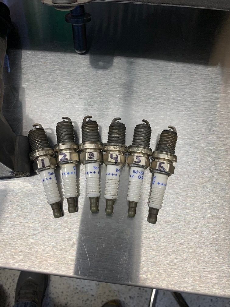

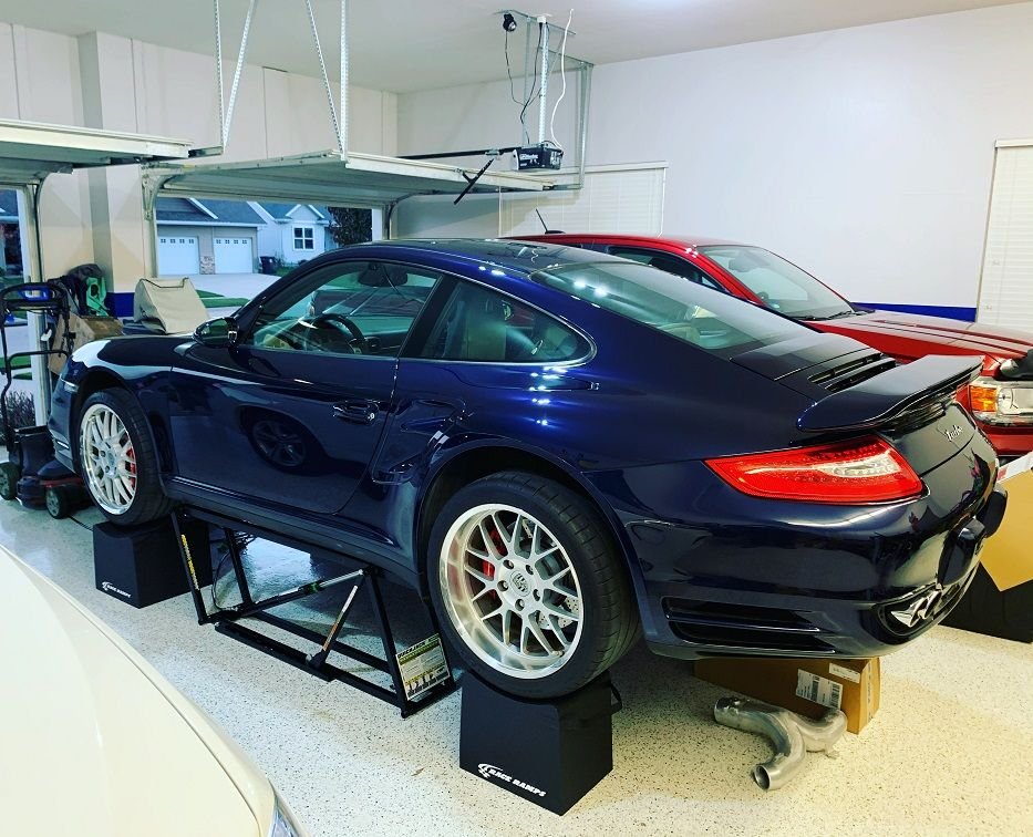

Been a while since I have posted an update, figured now would be a good time as the season starts back up.
I have owned my car since February 2016, bought it completely stock with the majority updating and upgrading starting in May 2016. All 6 years the car has run e85 most of the time, Protomotive 63.5 VTGs for 5 years out of the 6, and tuned 100% of the time by Sam. In summary 700-800hp+ range for the 6 years, for a total ~20k miles while modified. I wanted to mention this for a few reasons: I know a lot of members are always looking for long term examples of e85 use, mine would be a good data point. I never let the e85 sit in the tank (want to avoid corrosion and water issues)...if I'm not gonna drive it frequent, then I switch to gasoline. I also use good oil Amsoil and change it once per year. As far as the engines lasting long term while tuned, again I would say mine is a good data point. Good maintenance, good fuel, don't beat the **** out of it, and the keystone piece a great tuner that also knows when to put the brakes on your constant drive to squeeze out the last drop . In my case Sam has filled that spot since day 1, the car running as good as it does for the setup and as long as it has given my tune pushes, its really a testiment to him bringing my whole setup together. Sam being praised by his customers online is nothing new, but I felt the need to continue to reinforce that given his awesome service over the years.

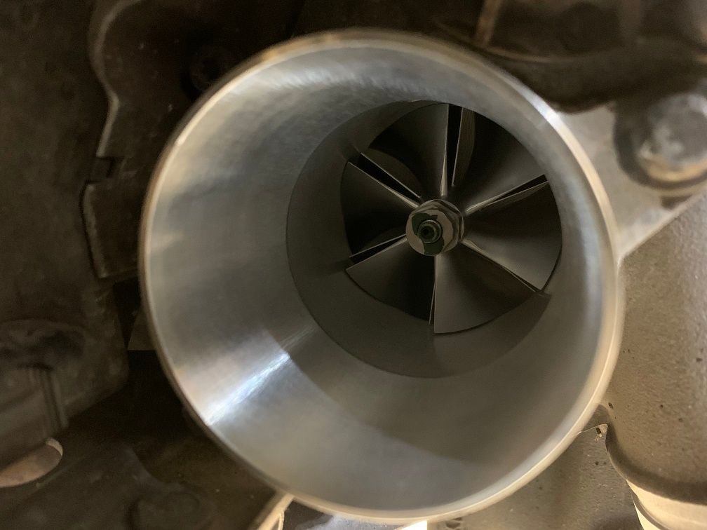

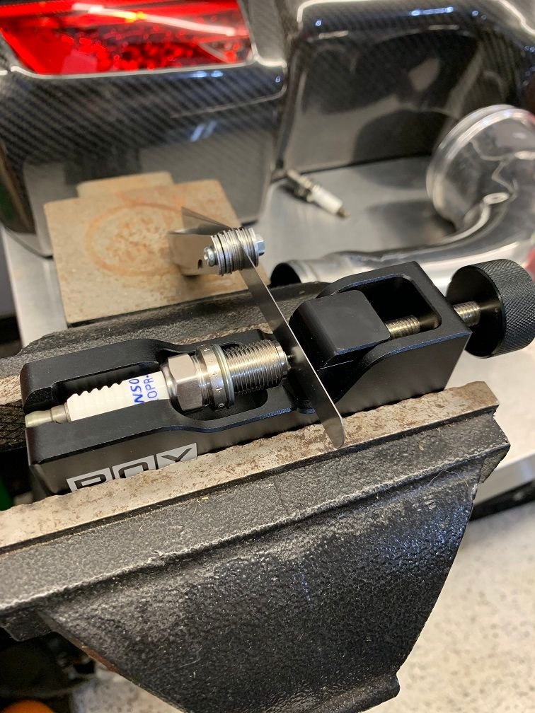

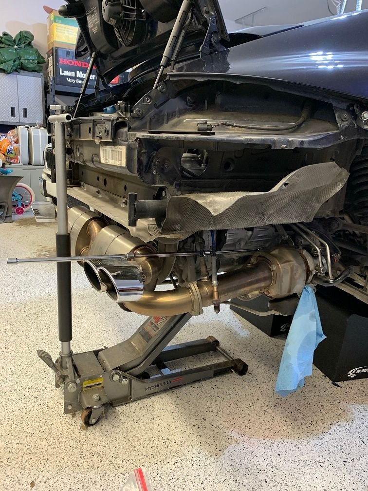

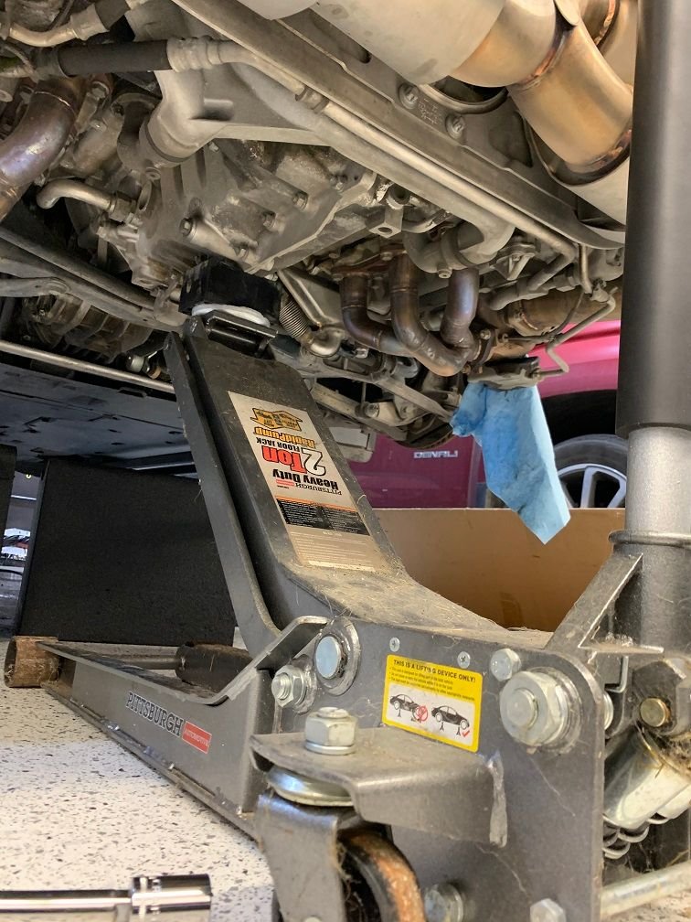

Now for the not so fun part.....spark plug change, compression check, fuel filter, clean MAFs, inspect turbos, grease VTG linkage, etc. As everyone knows it not a fun job, but it was time. Compression on all 6 cylinders was excellent with max deviation of 2.5% and an engine average of 216psi in a cold garage (hasn't run since Nov). Inspected the turbos, they look as they did when I pulled them out of the box 5 years ago. Spark plug wear rate was ~ .00175" / 1k miles at my power level. All the coils were in excellent shape, I use the "fat" BERU coils Sam recommended to me.
Below are some pics of my pain
