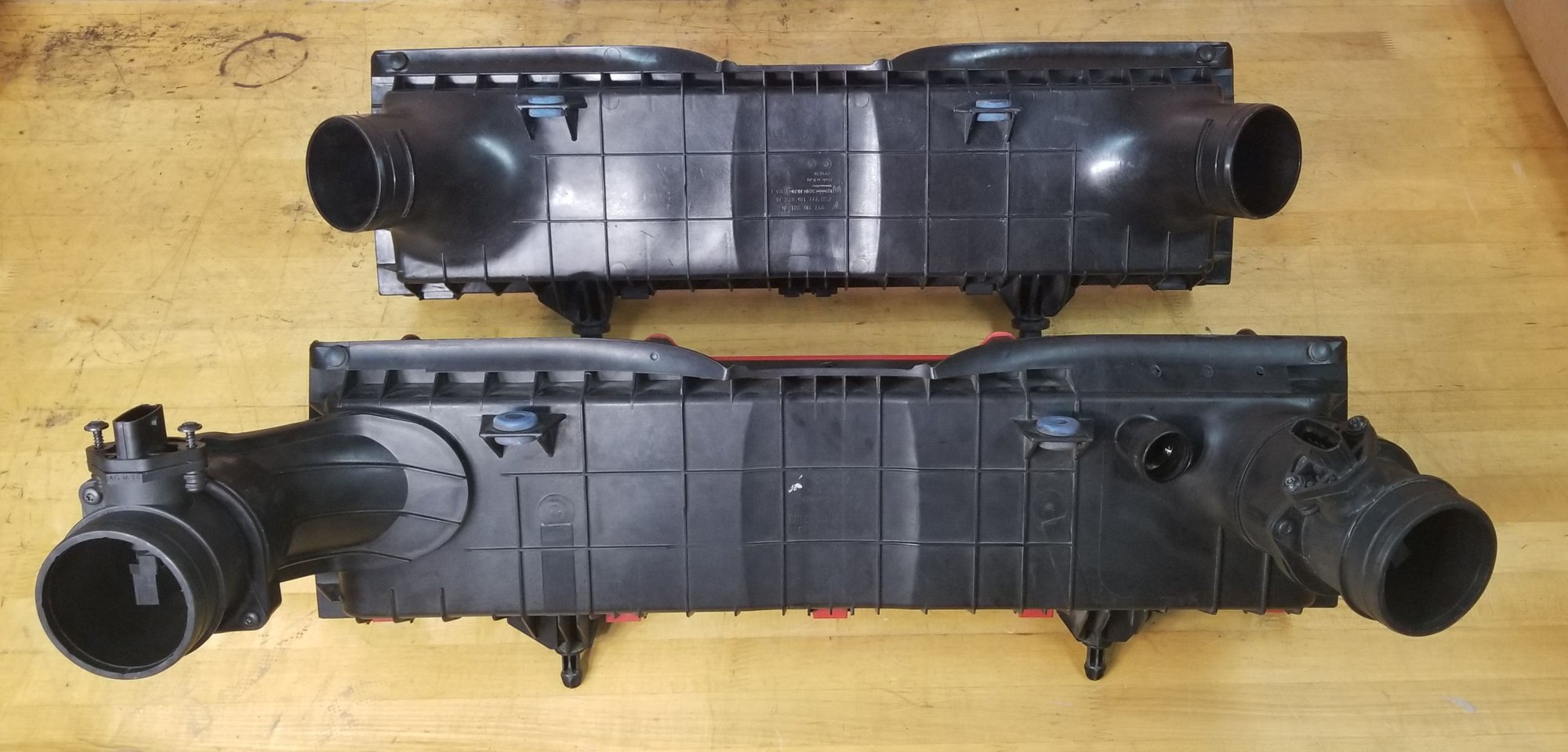

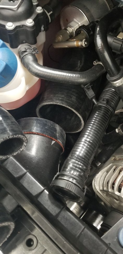

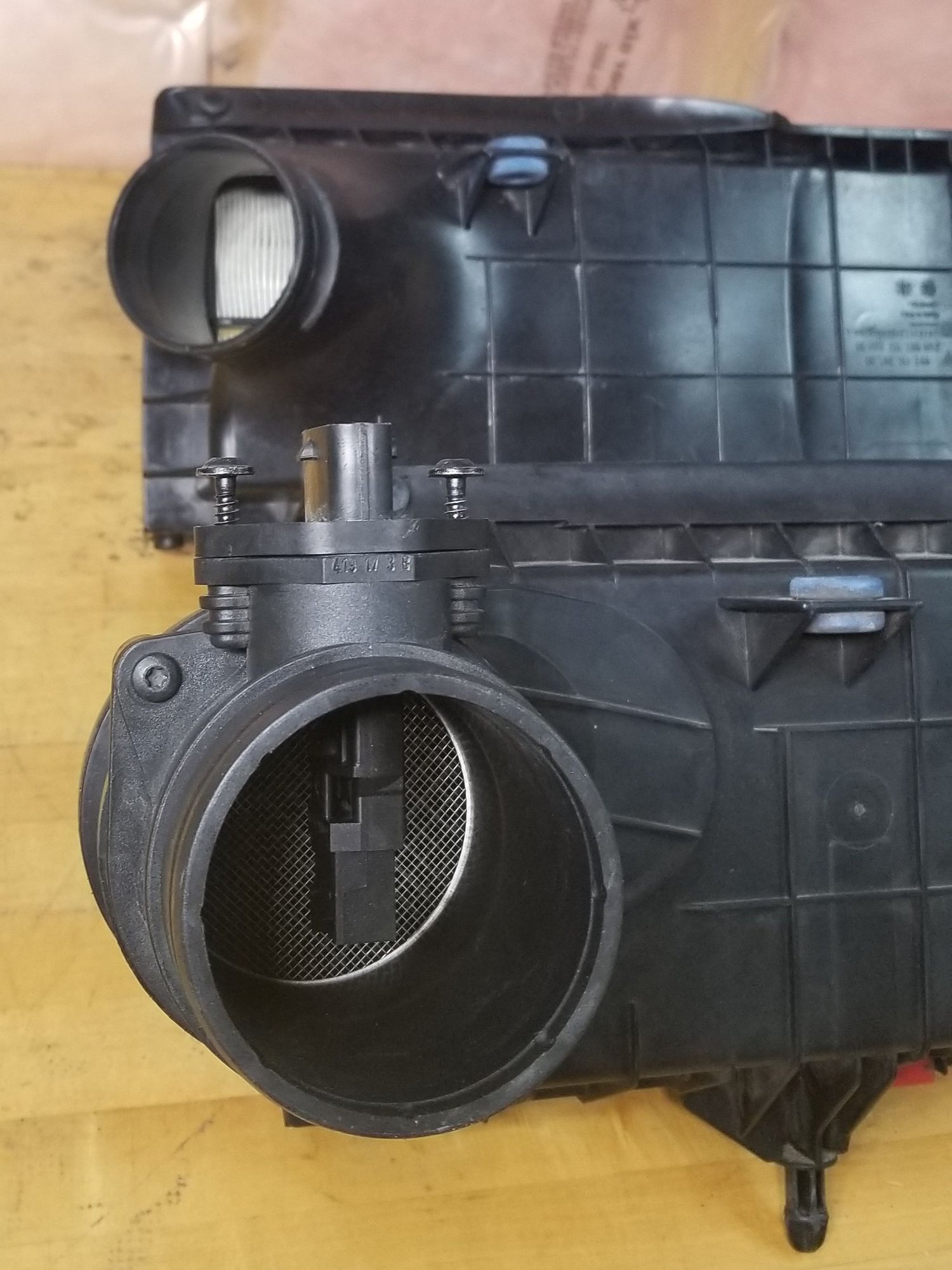

Old Nov 14, 2018 | 04:26 PM
  #180
DOOBEE's Avatar
Joined: Oct 2012
Posts: 143
From: Newmarket, Ontario
DOOBEE is infamous around these partsDOOBEE is infamous around these parts
I'm making some changes and want to run a stock airbox and silicone inlets. I haven't seen a solution I like better. I had both generations of airbox to compare and decided to use the .2 box for a few reasons, one being less restriction.
The grills, mesh, and sensors in the MAF assembly look like they would have a negative impact on flow. Not using them was incentive to lose them. These are bolted to the .1 box making connection without them more complicated.
The outlets on the .2 box are at different angles than the .1 but they dont have integrated MAFs and instead have flanges. Contrary to what I had heard, the .2 box fits in the .1 without interference anywhere.
I plan to use a 30 degree coupler and straight joiner on the passenger side and an offset coupler and 15 degree joiner on the driver. I'll probably have to trim the inlet pipe back a bit on the driver side to make the connection.
