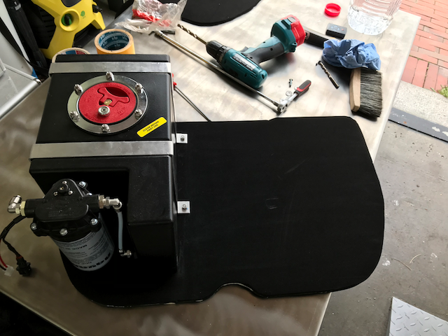

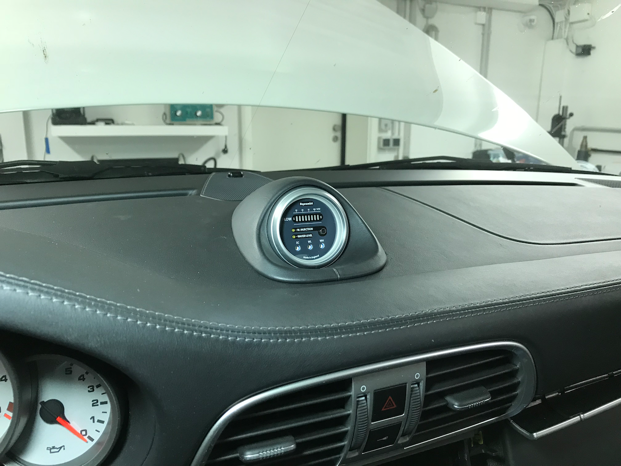

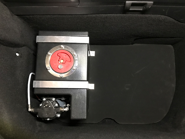

Here are some installation pictures from the last 2 weeks. Today I finished the electrical work and tomorrow I will start the system up and test the nozzles.
ID:	525634   Click image for larger version
When some WMI makers advice to have the pump located lower than fuel tank, wouldn't be better to rotate your pump to keep the fuel lines at the bottom?
Old May 12, 2018 | 04:06 AM
  #139
GT996's Avatar
Joined: Oct 2011
Posts: 429
From: Germany
Rep Power: 61
GT996 has a reputation beyond reputeGT996 has a reputation beyond reputeGT996 has a reputation beyond reputeGT996 has a reputation beyond reputeGT996 has a reputation beyond reputeGT996 has a reputation beyond reputeGT996 has a reputation beyond reputeGT996 has a reputation beyond reputeGT996 has a reputation beyond reputeGT996 has a reputation beyond reputeGT996 has a reputation beyond repute
Yes, but the other theory is that air bubbles could then be trapped in the pump. I decided to go that way because that's how some WMI makers install them. The "pipe" length to the tank is like 15 cm or so (sse pic). The pump won't have any problems to get fluid - in fact I tested it already and it just primed perfectly from empty to full flow within 5 seconds.

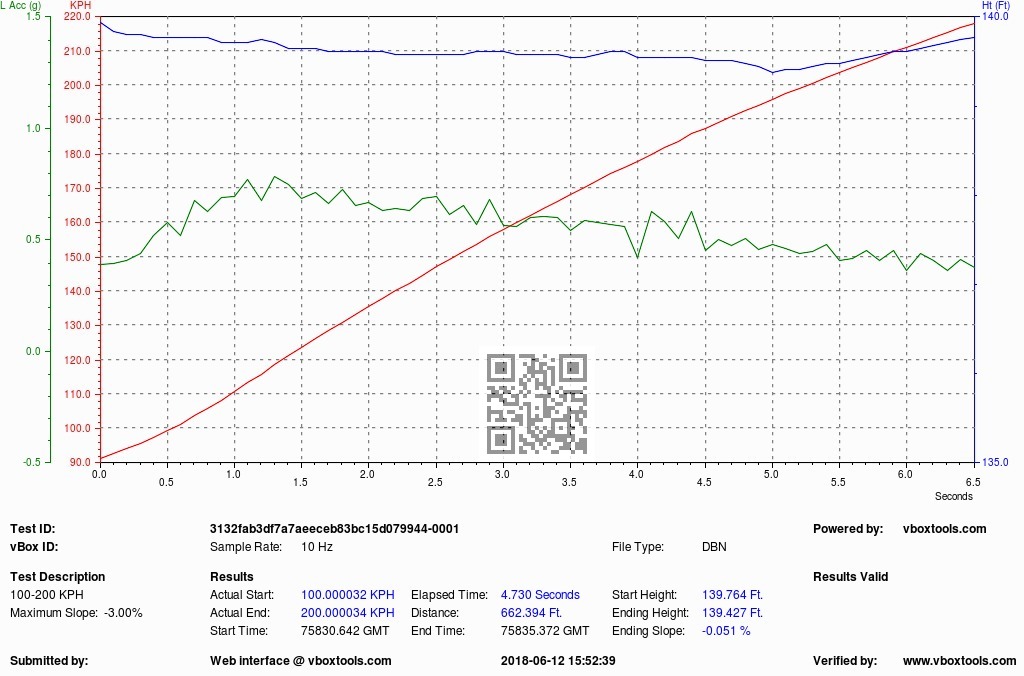

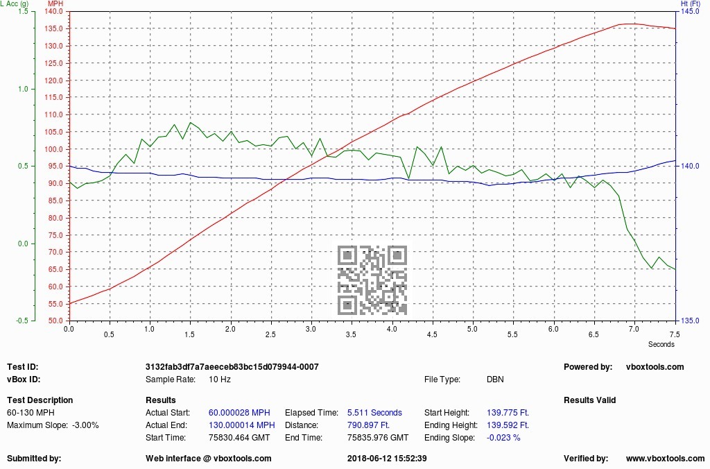

I had a lot of little hardware bugs to fix and time went by waiting for parts, but the project is moving forward now.
100-200 kph 4.7 and 60-130mph 5.5 on a flat surface with almost full fuel tank. No brake boosting or any tricks, just pedal to the metal in 4th.
IAT is now down do 37.5 degrees C at 308 kph, which is really great.
770 hp and 1060 Nm is not too bad for VTG turbos - I think I will not get my 800, but I have one or two things left over to try.

Thanks. In 3rd I get exactly the same 100-200 time. Shifting in 3-4/10ths and immediate acceleration in 4th, but I land exactly on the line of 4th gear as if I would use just 4th.
If I would make a bet with the gearbox, I probably could gain 1/10, but not more.

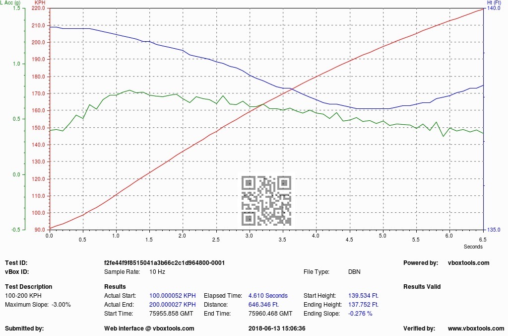

The car is ready now. I found some more hp and am down to 4.6 seconds 100-200 kph and 5.4 seconds 60-130 mph.
786 hp and 1080 Nm - that's it. Not too bad

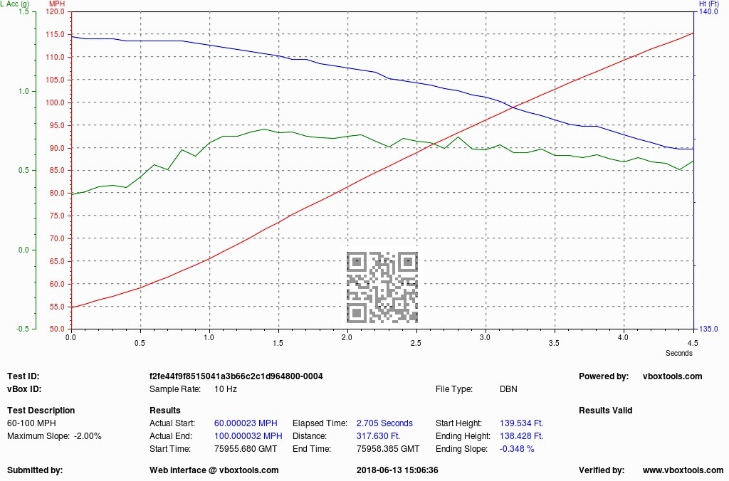

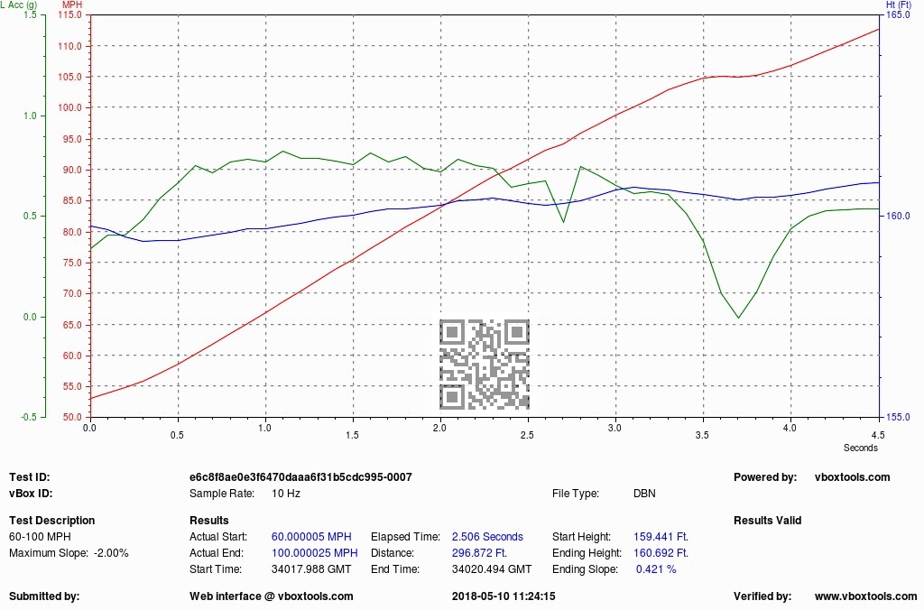

I mean, it's not that I can't . That's a time midway thru the project. Haven't done many 3rd gear pulls, but here is one and I bet I am quicker now, but that's only a guess until I try again. 2nd chart is 4th gear as of yesterday.

Originally Posted by IMI A
We're getting consistent 2.6 secs 60-100mph on a map which gives us a consistent 16-17 secs 60- 300kph
On racefuel, big GT2 hybrid VTGS and no cats.
One notch down from my 2.5sec calibration it runs in the 2.6s, we are lining up pretty well (all #s using E85). Thanks for the info
