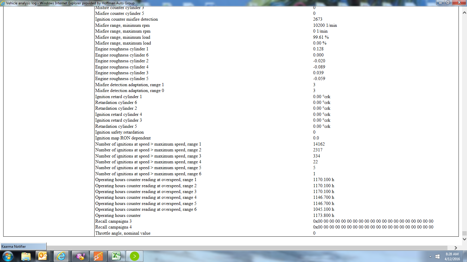

5th and 6th overrevs could be problematic. How many hours since the 5 and 6?

The service rep. said he will try to get the DME readout in the morning. Will update tomorrow. Also the dealer who I am purchasing the car from is offering to fix the accumulator and horn at their dealership or he will give me a 1K discount on the car and I can fix the car at the Porsche dealer. I would rather have the car fixed at the Porsche Service center just for the piece of mind.

Over Revs Attached!
Number of ignitions at speed > maximum speed, range 1 14162
Number of ignitions at speed > maximum speed, range 2 2317
Number of ignitions at speed > maximum speed, range 3 334
Number of ignitions at speed > maximum speed, range 4 22
Number of ignitions at speed > maximum speed, range 5 5
Number of ignitions at speed > maximum speed, range 6 1

I should have the DME readout for the second Cab later today. Please let me know what you think!
