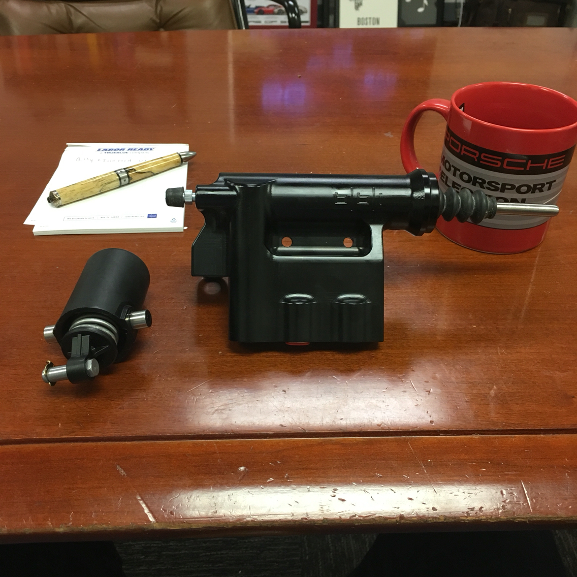

BBI clutch slave install and review.
I got tired of waiting for someone to give me/us feedback on this anticipated product. So I called Betim and a few days later it showed up.
Keeping in mind I run a defense company that manufactures machined parts for the government I tend to be critical. The overall quality of the slave is great from a function and practicality standpoint BBI did an amazing job. My critical side would have liked to see better tool step over on the surf milling.
With that being said the install went super smooth. Took 2.5 hours which included a oil change. The starter nor the axels needed to be touched. This job has a few challenges one being the red compression fitting can be a pain but I made a tool that made it a breeze to undo. The next is pushing the slave to the rear ensuring it stays in the divot and overcoming the tension to get the slave bolts in. Again not too bad, but can be interesting.
I did also install the GT3 clutch spring which does help a lot.
Without the clutch spring the clutch is 15% firmer than a GT2/GT3 factory clutch. With the GT3 spring it's less firmer than the GT2/GT3 clutch pressure.
My initial impression was the pressure feels awesome. The first drive landed me in 10 mile interstate traffic lasting 25 minutes. Nothing crazy but a lot of shifting. The pressure / effort wasn't anything to speak of. I've put a few hundred files through the clutch and I love it.
It's totally changed how I drive the car, from a dig the car slams the power down. On upshift there is zero decel surge. The let out is perfect. This would be the first modification I would do a stock 996/997 turbo.
I have driven and or owned GT2, GT3 , GT4 , 991 50th 7MT, and EVOM slave converted turbos. My current 997TT has all the supporting modifications to produce over 700hp and 691 ftlbs AWD including a upgraded SACHS clutch and LWFW. The BBI clutch slave is a must, and is the best available slave conversion I've ever experienced.
BBI awesome Job.

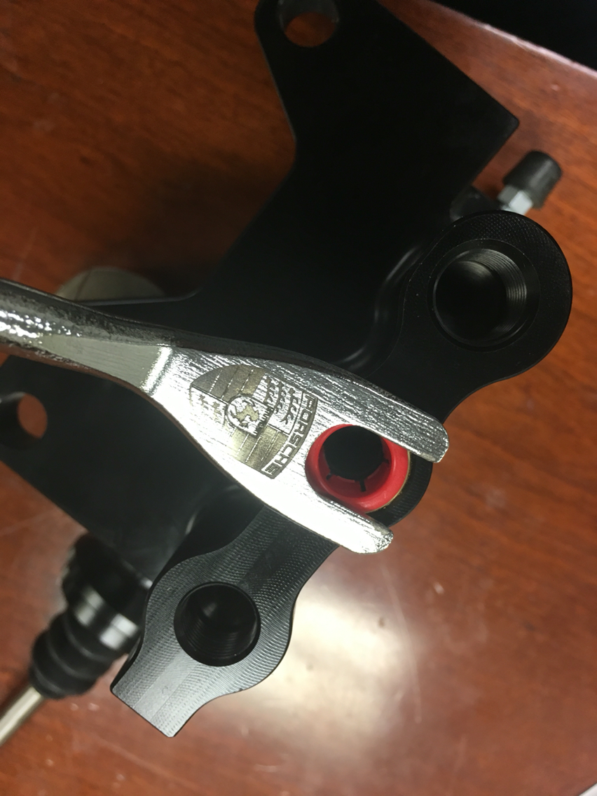

Thanks for the feedback! Can you tell me more about the red compression fitting? D0 you lift it up, slide a tube in then push the red fitting down?
With the tool I made you slide it between the red comp fitting a the bulbous on the line and it's you insert the tool the line simply comes out.
With out the tool you'll need to push in the red fitting while pulling out on the line. The PITA part is you need to have enough radial contact I the red comp fitting for it to release.
