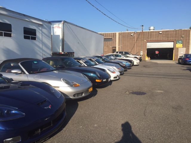

I've attached a couple of pics of the track beasts they have over there.
