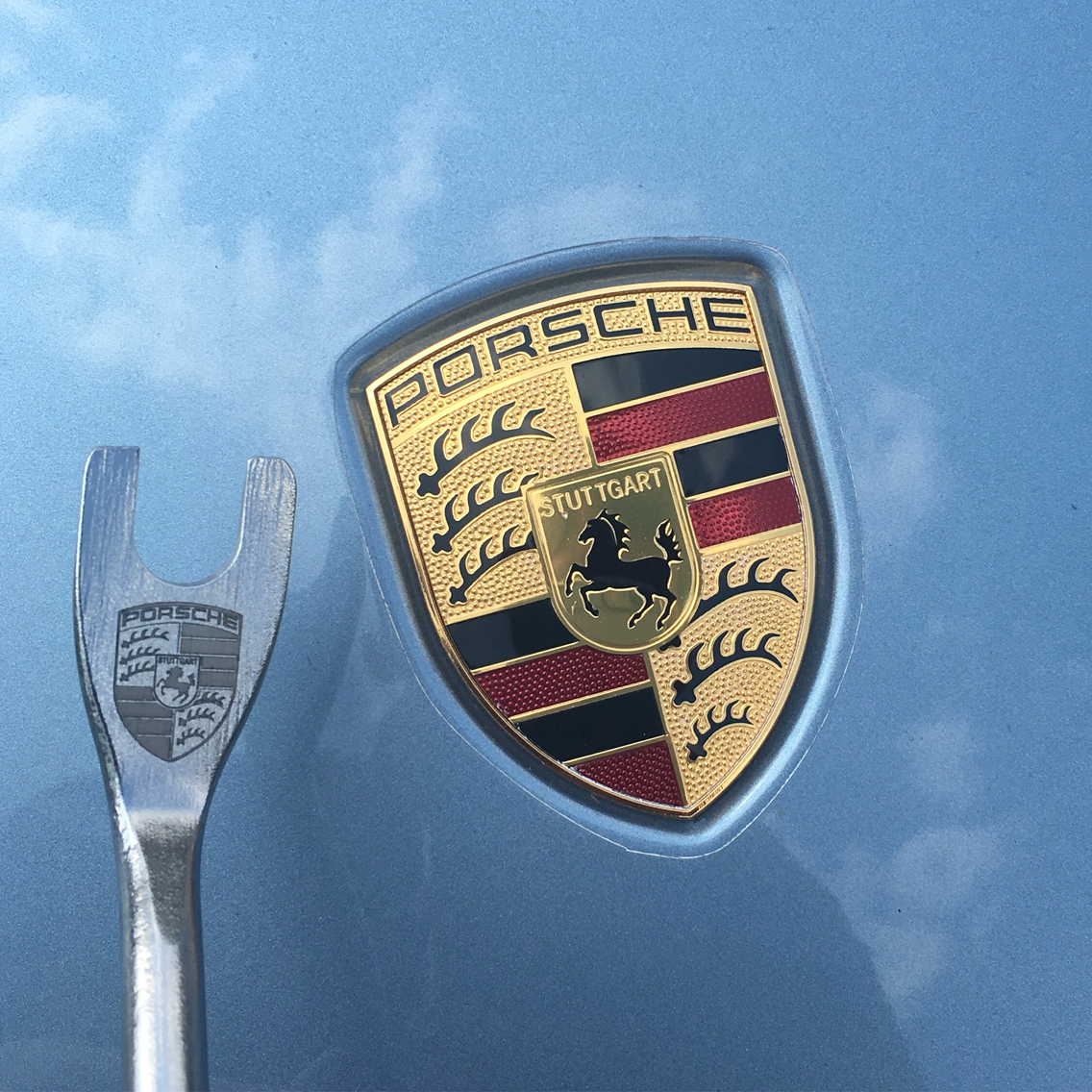

I made a clutch slave tool.
This tool is to assist in removing the line that has the red compression fittings on both the clutch slave and power steering pump.
Anyone that has ever had to remove that line knows the PITA that fitting can be. This tool makes it very very easy. If you plan on a slave swap or pulling the engine you will love this tool. Tell your techs and they will be very glad you did.

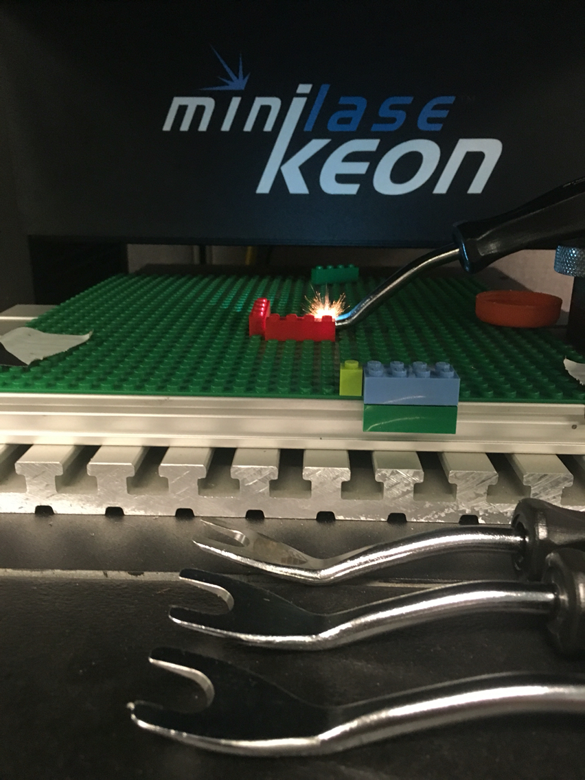

I love idea creators/ inventors! A photo of the tool in use would be great! I thought of a large weed puller or a open end wrench with logos by your photos.
I get the T-lock table but i don't get the gatorade cap and lego parts??

Is that an interior panel removal tool?

Well I came up with the Legos as a cheap reliable way to locate parts on my laser marker. The Gatorade cap was used to hold a round part I was also marking. Once you sink a thin disk down the cap is a great way to quickly locate and remove from part to part.

It started its life as a snap on panel tool. I had one lying around and milled the slot larger and put the radius that corresponds to the diameter of the line going into the slave. The laser marking is just fun, but I have a extensive tool collection and buddies almost always grab that tool. Well that or the bottle opener.
