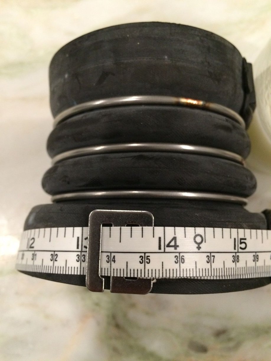

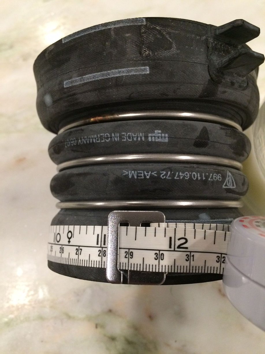

I have a spare y-pipe/throttle body coupler so I did some quick measurements. You can see the outer circumference for the y-pipe end as well as the throttle body end here -- just under 30 cm and 35 cm, respectively. The outer diameter (not pictured) is 4" and 4.5".
