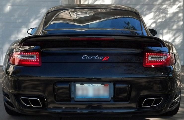

Originally Posted by SamboTT@ByDesign
We will get to the bottom of this. You have my full support Stuart and of course anyone else who needs it . Here’s a car that we are finishing up still at the shop absolutely perfect fit. I did put new mounts on it actually I had removed some aggressive ones as I’m not really a huge fan unless the car is on the track with everything else done to it. I just took this picture now
This looks much better than mine, and like mine did with an OEM exhaust. Did you have to do anything specific to get the fit so perfect? I tried everything from adjusting the straps to reseating the flanges - was disappointed in the end but didn't want to go through any more hassle.
