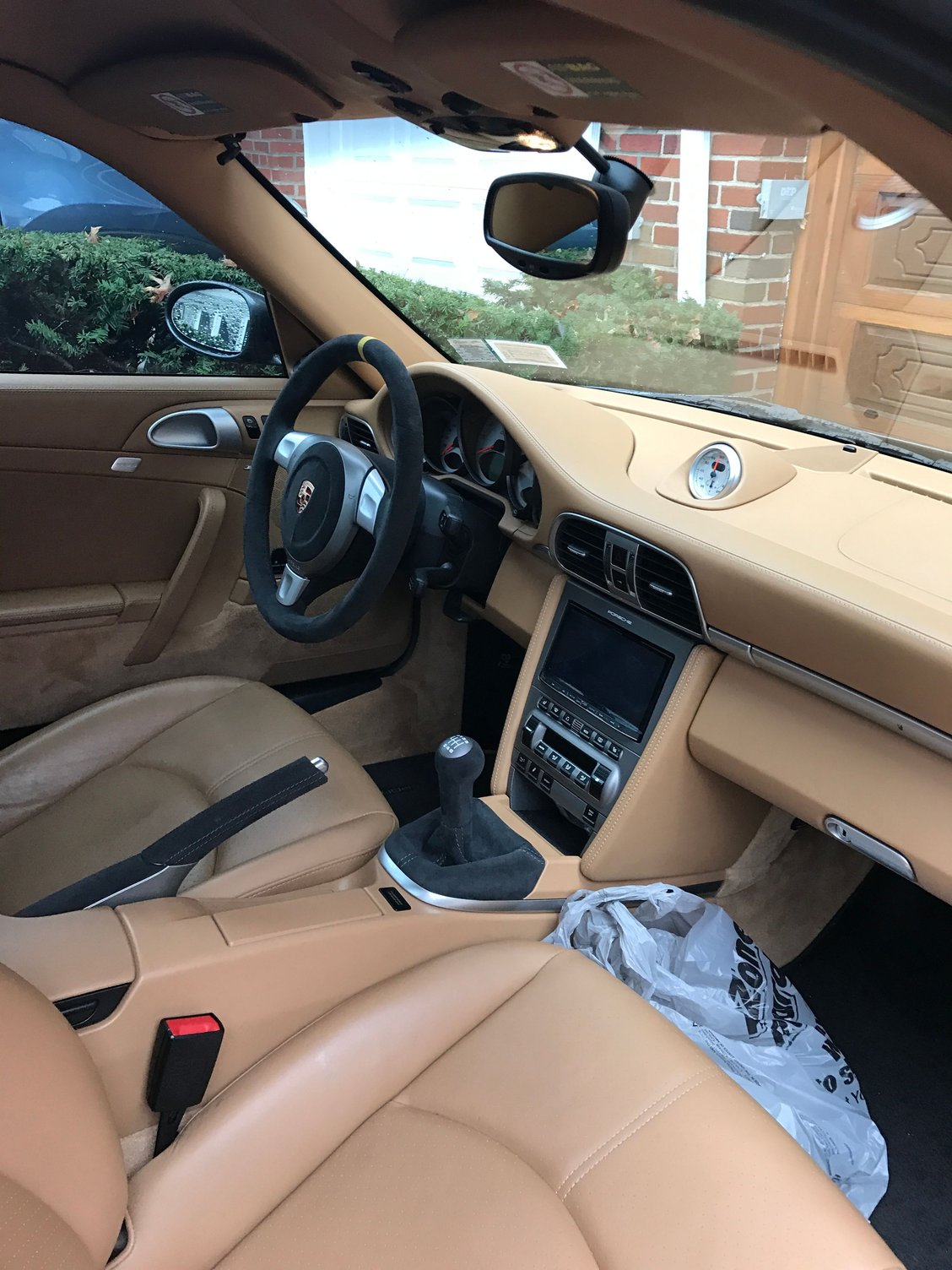

He's right but I have a pioneer AVIC nex 8200

This is how it is now

Nice black alcantara accents! And the steering wheel stripe ties it together nicely.
Re the aftermarket stereo, with one of those bezels I agree that it looks great - basically factory. If I had a PCM 2.1 I'd do it in a heartbeat. With a 3.0 though I don't feel it's worth it, given the cost, the loss of sport chrono features (fairly trivial ones, but still), and the fact that as likely as not it'll be a negative rather than a positive at resale. Of course you can always switch back, but the aftermarket stereo won't be worth much at that point, unlike many mods that have great resale value.
Instead I just got a proclip mount so my phone sits just to the right of the climate controls, which is something I probably would do regardless, and handles anything the PCM isn't great at.
