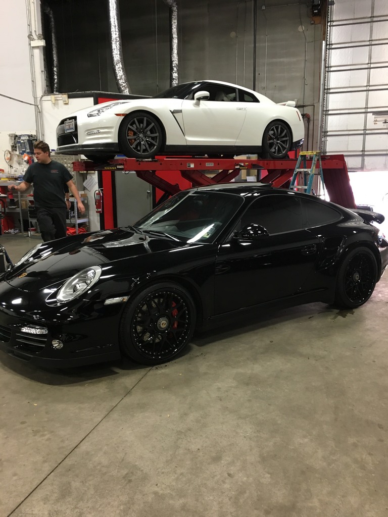

No issues what-so-ever with my 20" HRE 590RS.
