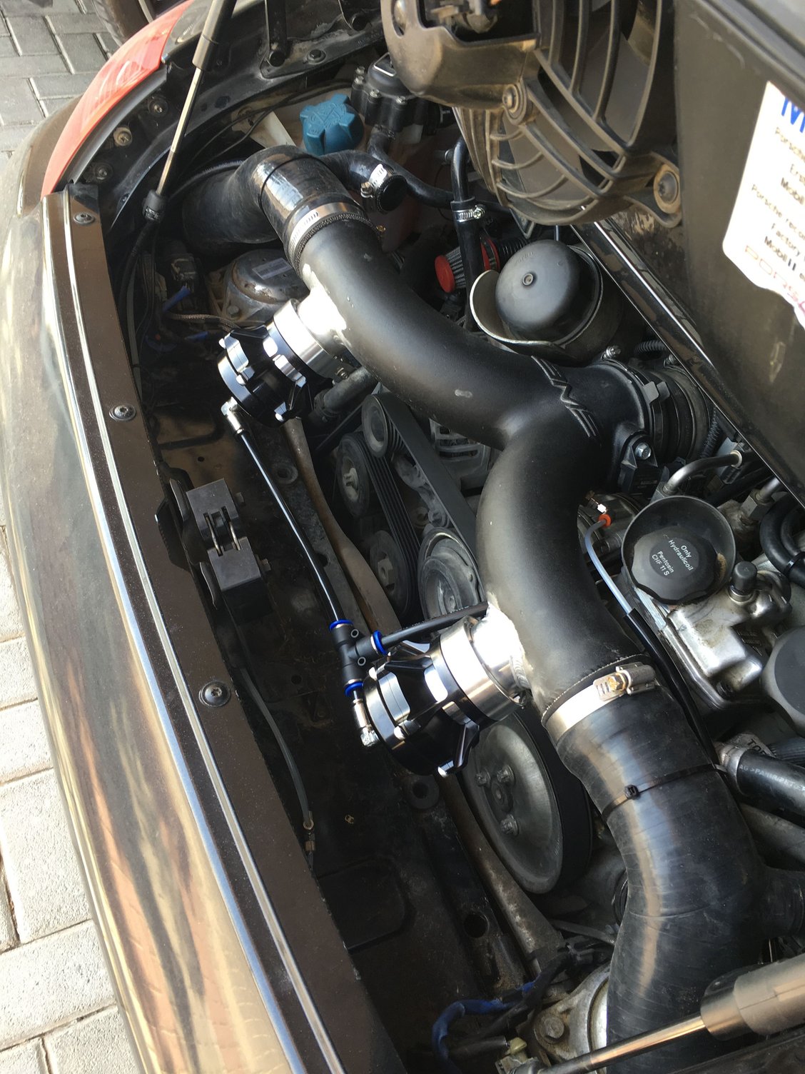

Hi,
I am putting DO88's and the stock airbox back on my car because its now in the UK (Filters currently on turbos).
Because of this I have to move my current BOV's from the Y pipe and put something in the stock AMS intercooler location in the engine bay.
What are you guys running in that location?
Ive been looking at forge, link attached. But the last forge ones I had weren't that great.
https://www.forgemotorsport.co.uk/Po...uct--1407.html
Also in my current setup I have two Tial Q50's with 8psi springs. With the type above will I have to spring match to 8psi too?
Does anyone think there will be any noticeable performance loss?
Thanks!

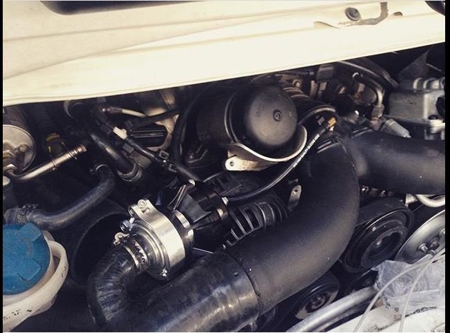

Here is a picture of the current set up and another of what I want to go back too.

This works
The adaptr is from the jdm world, using just the 1 the Q50 is huge its enough, but had to change the spring to -11 iirc to keep it closed at idle.
I ditched the oem box but still run this setup. If you're set on changing them look into the Tial qrj

I wanted something smaller, I had tried the QRJ's before I got the Q50's but they didn't fit in the stock AMS locations. Atleast the right side didn't.
I think the out of box alpha9 kit uses stock Bosch ones. I might look into that.
