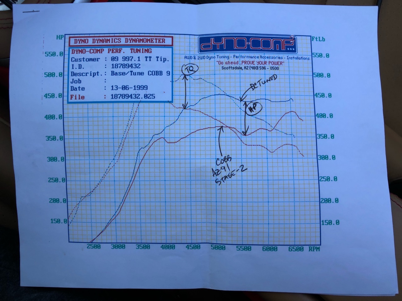

So I went up from Cobb Stage 1 to Cobb Stage 2 ( FVD 200 Cells Cat exhaust system ). Now recently I just had a Cobb Dyno Pro-tune..
Here is something I do not understand.I have contacted Cobb but then answer they gave, lets say " user friendly"
Of course I understand," at the end of the day hp gains are different for everyone and there are many variables that go into play when measuring those numbers, fuel type, temperature, different dyno's will give you different numbers, etc."
Ok . From Cobb Website it says Stage 1 gain about 10% HP 8%TQ. So that will be 480HP out of the box + 48 ~ hp should make the car around 528HP.
Now the Stage 2 require an aftermarket exhaust. gain about 17%hp more will make the car about ~ 561HP
Now after the Pro-tune. The Car now makes 550HP ( 450 WHP ) and 500TQ, The tuner told me he picked up about 50HP over the Cobb stage 2…
BTW the Pro tuner was a great guy to work with...

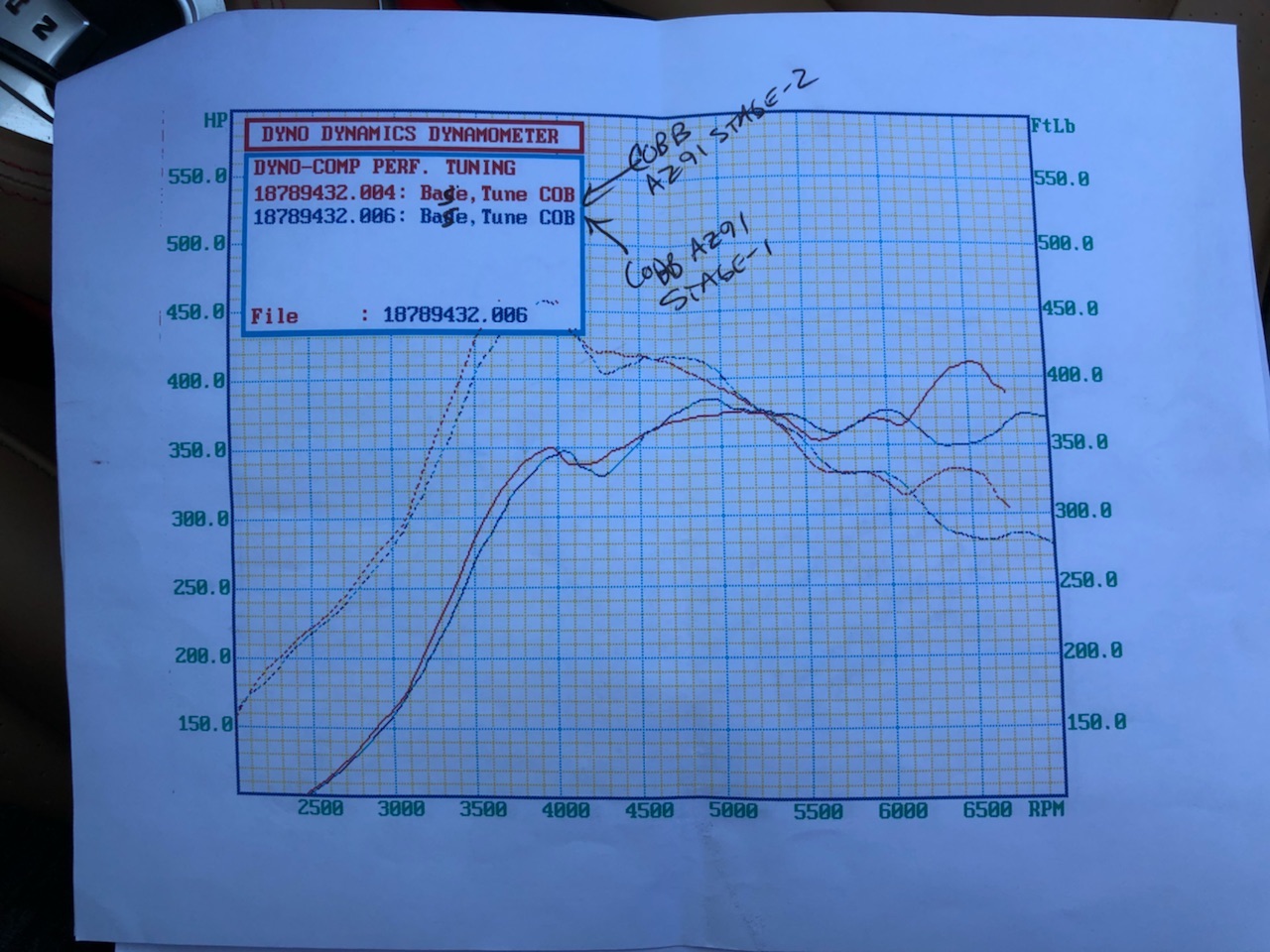

For my car the Stage 1 and stage 2 almost same power..
So my question is .. Protune pick up 50HP that make the Cobb stage 2. 500HP. Which only 20 HP more then the stock? Also on the dyno Cobb stage 2 showing 400WHP… 400X1.23= 492HP . What happened to 17% to 24% gain?
I have a friend who has the same car as my, and runs with GIAC stage 2. On dyno it came out close to 600HP and a lot more TQ than the Cobb.
Please do not get me wrong, I love the Cobb AP and power.. just want to understand where all the power went?
Here are the dyno sheets.
Thanks for all your help...

seems like a low reading dyno, the stock vs final tune looks like a good pickup. That's my impression

Dynosheets are "useless" without a base run before tuning. Different dynos read different #`s and are meant for tuning. When tuning, use the same dyno to compare results for each thing you change.
You are after the delta when doing mods.

I can tell you from personal experience my Supra makes a 100hp difference on a DynoJet versus a Mustang Dyno. Overall it sounds as if your tuner has created a tune specific to your car and the conditions that day and all is well. Don't be stuck on the numbers, its all about the drive ability.

I agree with you... but is kinda shocking to see that Cobb stage 1 and 2 are the same power and only picked 20 to 30 hp more then the stock for my car..

Yes I am thinking maybe do a different see the difference?
My dyno graph is kinda all over the place.. I do not know if I have a boost leak or not... Also I just noticed I set shift at 6500 RPM from Cobb AP.. that may have something to do with it?

Maximum dyno numbers aside, your car didn't like the off the shelf Cobb mapping that was loaded. See how wavy your curves are? That's all signs that the ECU was unhappy about something and was likely pulling timing and possibly boost to correct for it. This is a great example of how pro tuning and mapping each car is by far the best solution. Every car is different. Mine required base fueling changes even with the stock injectors to get the short term fuel trims in check.
Finally, you can see how much smoother your graphs are after the pro tuner was done. It is obvious the ECU is no longer reacting to issues with the tuning as before.
