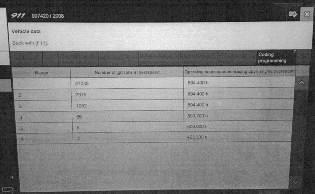

You put way more faith in their infallibility than I do. For example, take a look at this report from this thread:
It is utterly implausible to register 2 range 6s and only 6 range 5s, again based on how fast the crank is spinning in those ranges and the fact that to brush into range 6 means it needs to fall all the way back down through range 5. And this report indicates two separate events in range 5. This is just one of dozens of reports out there with impossibly brief numbers in the upper ranges. Someone in a thread on PistonHeads a few years ago was also able to demonstrate with an engine removed from the car that it's possible to add spurious over revs. Anecdotally, it seems like cars with DME tunes are more susceptible to suspicious numbers.
I'm not saying the dealer didn't zing this car, since the range 3s are certainly real, but I strongly doubt it actually went into range 4.
