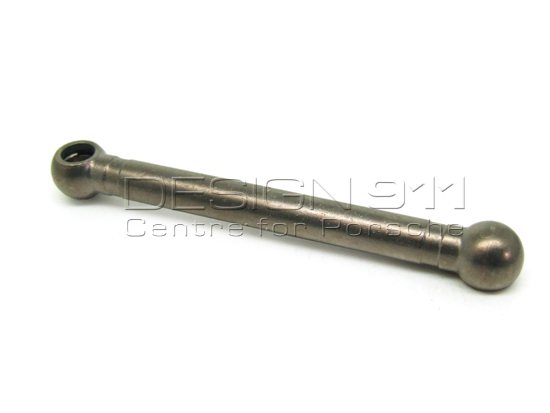

TURBOCHARGER OPERATING ROD CYL. 1-3. PORSCHE 997 TURBO
Code: 99712312
Turbocharger Operating Rod Cyl. 1-3.
Genuine Porsche product
Fits:
Porsche 997 Turbo / GT2 2007-09
Porsche 997 Turbo / GT2 RS 2010-13
part numbers are
LEFT 99712312370 (£30.55)
RIGHT 99712312470 (£30.55)
Thats from a uk site for the actuator rods

Was able to pick-up that car and running well once again. Guessing the passenger side turbo was the culprit for the change in sound and power/response as the arm broke and left left the turbo in the open position and not building boost.. The driver's side turbo was seized and in the closed position, but the shop was able to get that resolved as well. I believe the driver's side was seized when I got the car as my only gripe about the car since purchase was the touchy on/off clutch engagement in first gear. I originally attributed it to the upgraded Sachs clutch, but now that turbo is issue is gone, it resulted in much easier engage of the clutch. Must have been building a small amount of boost with the turbo in the closed position that was creating the challenge of getting going in first gear without it being choppy or killing it off the line. Very happy for this unexpected improvement in drive-ability, especially when in some stop and go traffic.
Thanks to everyone for your thoughts and input. It was very helpful. Ended up that a couple of new actuator arms and several hours of labor was all it took. While a part of me was ok with the thought of upgrading my set-up due to my turbo issues, the timing for that type of expense can now be better planned for.
