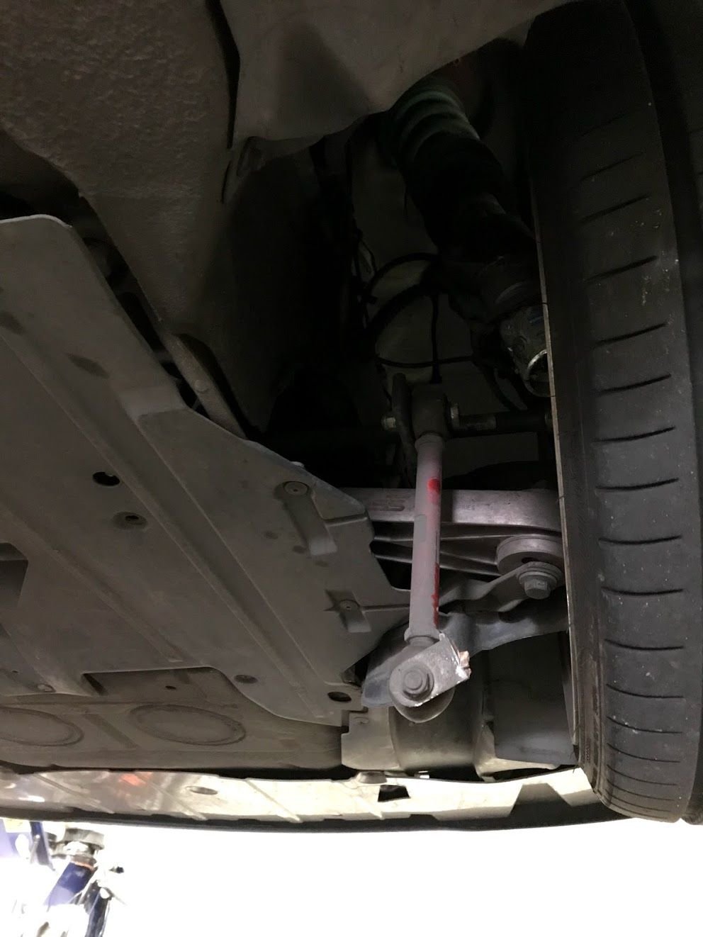

Part of this is dealing with a failed bilstein drop link mount (not the drop link itself - as I'm using Tarett drop links for mine - actually the bilstein mount failed).

Bilstein shock mount failing. Yes, the shocks are better than stock (for performance), but their mounts, for their drop links, are the weak point - they are S**T!!!
--- DO NOT BUY BILSTEIN AFTERMARKET SHOCKS!!! ---
Unless you're like me and are a sucker for punishment.
More on the suspension...
Had issues with my aftermarket bilstein struts multiple times. If you do a search here, you will find I had two catastrophic failures and this is the third. Bilstein shocks are plain JUNK.

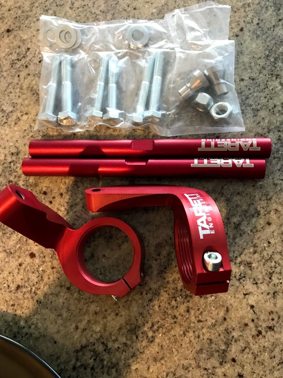

Further on the suspension, I'm working with Tarett to completely replace the flawed Bilstein drop link mounts and changing the front geometry entirely with Tarett's extended drop link kit. Pretty cool stuff if you guys are after perfect geometry. Tarett is a TOP NOTCH OPERATION.
Ira, who is my contact there, is outstanding. Working with him has been such a pleasure. Definitely one of the top recommended tuner suppliers for our vehicles.
Totally recommend Tarett Engineering and will say that Ira is a LEGEND!!!
Here's the groovy Tarett extension pieces that IRA has produced for me, that fit the bilsteins I'm running...
