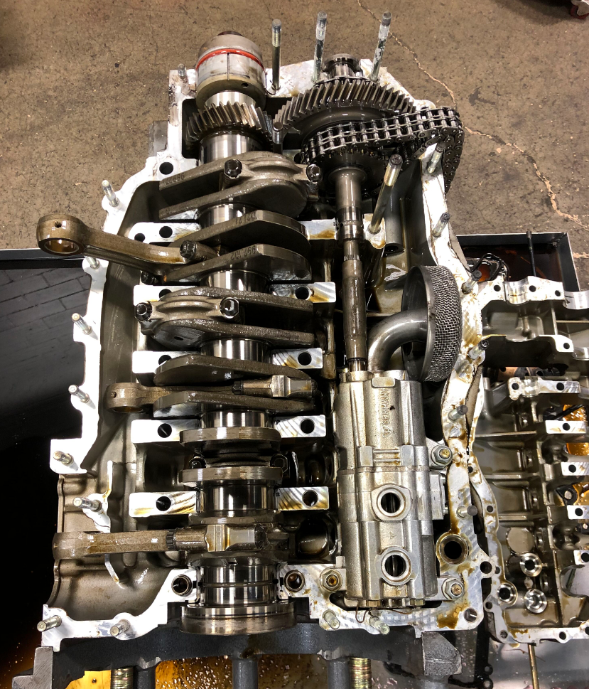

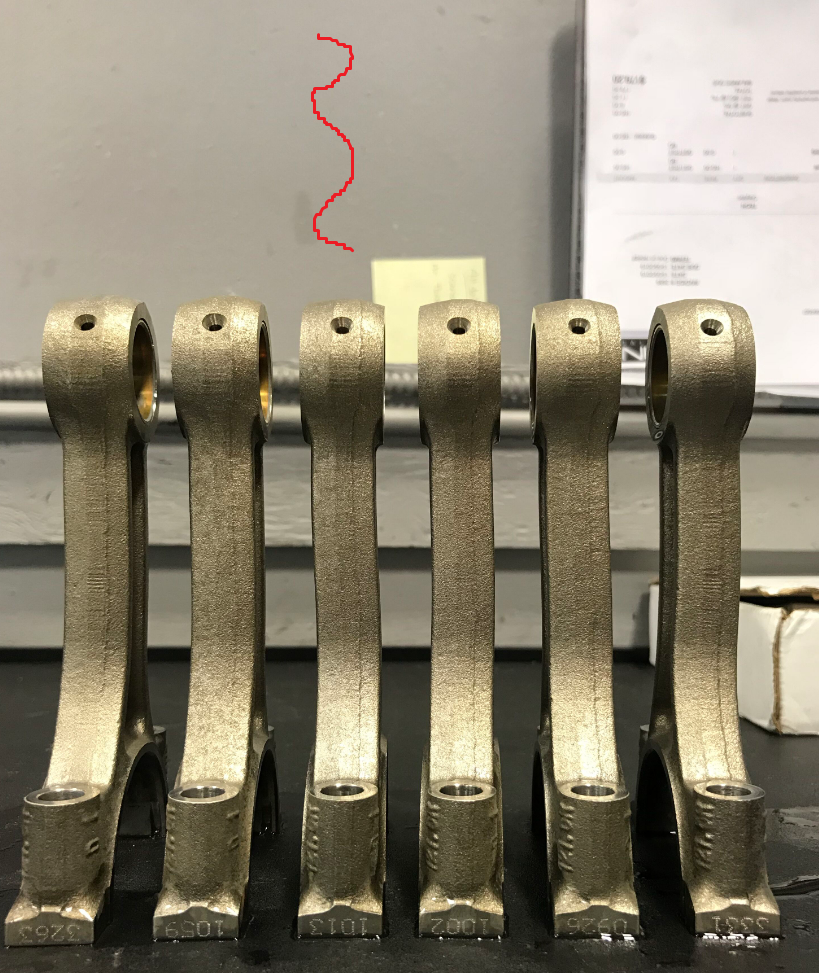

Things are progressing....
Nothing to see here... everything is perfectly straight

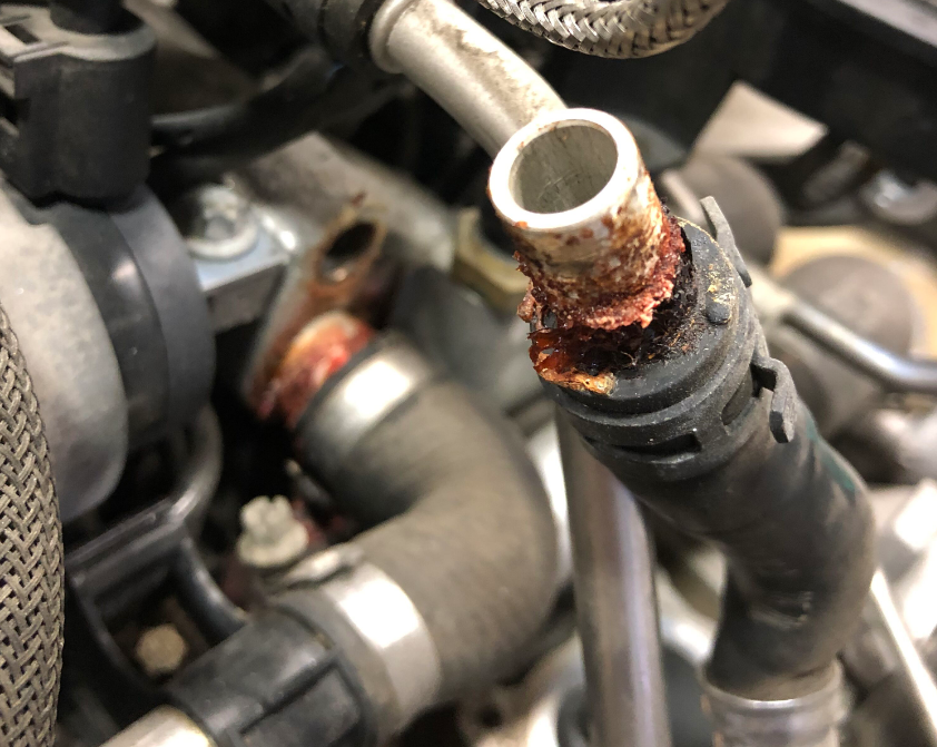

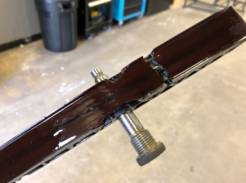

And the original culprit ...
Also ... amazing that I didn't get a nice coolant shower earlier.
These things were literally the walking dead!!!

Wow, you were lucky. I've experienced the coolant shower and it isn't as refreshing as it sounds.

Yeah, no kidding - my mechanic was amazed that they were still holding together.
Really, Really, Really good advice for any Turbo owner to have these replaced with steel / welded elbows.
