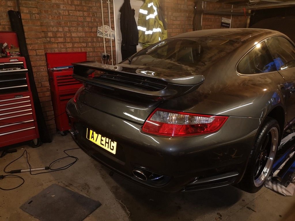

So the spoiler is now fitted to the car, I have taped up the existing wiring loom at the moment does anyone have the part number for the loom for a fixed wing is it the GT3 loom ?

The one listed on the TEQ Aerokit (I-no. XAF)
is 997 612 670 71 but I would call Neal at Sonnen Porsche to confirm there has not been some update. If memory serves me correctly it's a loom for GT3/GT2 (with 3rd break light). Car looks good. Congrats

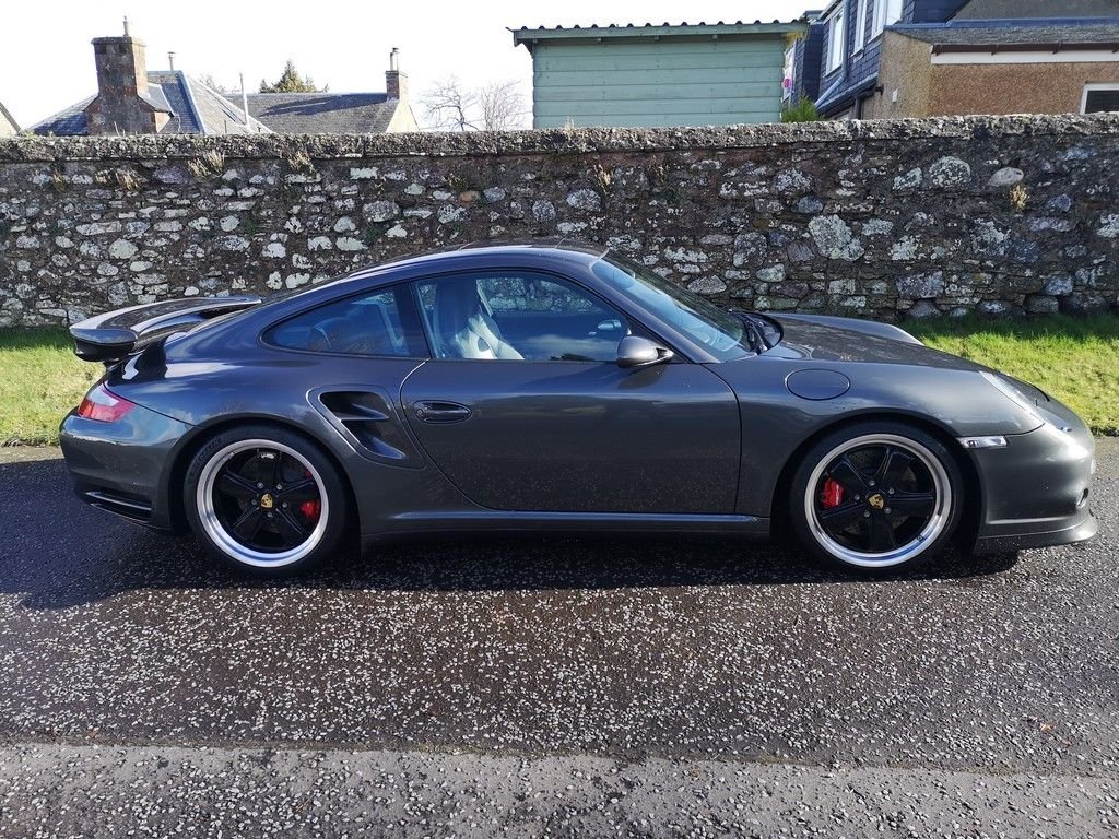

Thanks for that I have found a similar number 997 622 670 70 not sure if the 71 number you have is an update or the difference is one if with a 3rd brake light and one without ? some better pics of the car managed to get it outside at the weekend I have fitted lowering springs ,painted the skirts and fitted front aero.
