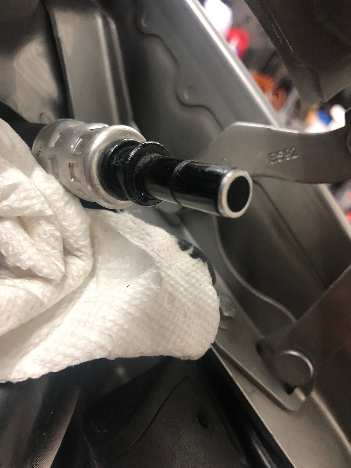

Based on my experience (with the PS Reservoir - not the slave) the connections that press into those red fittings are the most likely suspects. When I was replacing my stock slave (which I highly recommend you consider) I removed all the plumbing from the reservoir to the slave. After putting everything back together and the engine back in the car, I had a dripping leak from the reservoir. Originally I thought it was from one of the three plugs I had fashioned for the removed plumbing to the slave, but it wound up being the return line from the PS rack. Kevin at UMW recommends replacing the reservoir with one from a GT2 which does not have the connections to the slave, but in my case, even doing that would still have a leak since my hose end was damaged. The red fitting below was the source of my problem. If I remember correctly there are two of these on the slave.
The problem was this cut that went around the circumference of the hose (that looked so perfect I thought it was part of the design until Kevin pointed out the problem):

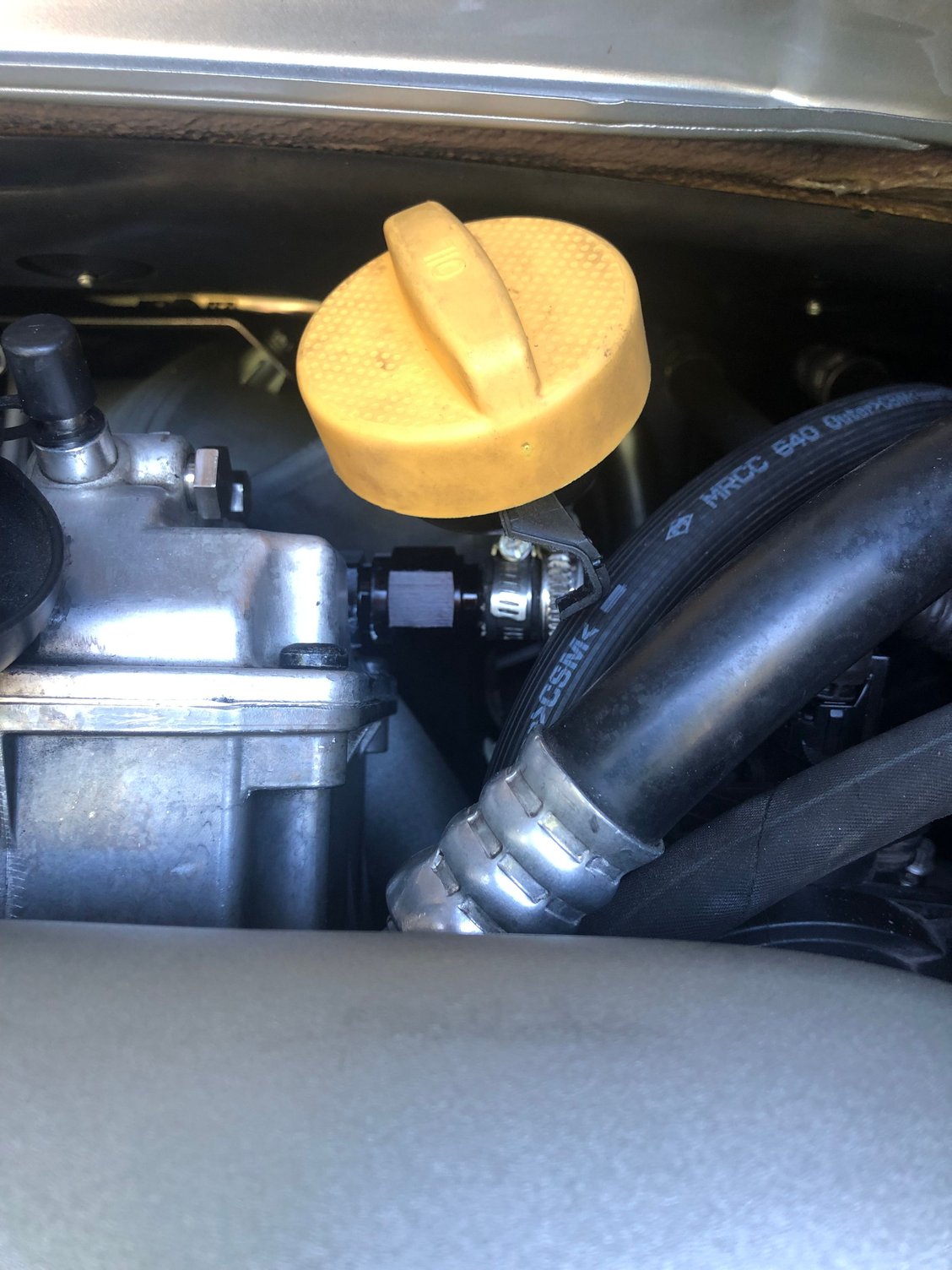

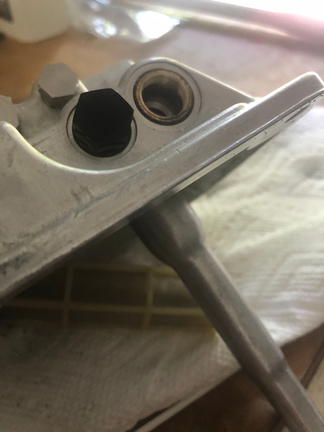

Since the solution was to replace the hose, which required dropping the engine that I had just put back in, I took a different approach and replaced the end and the fitting with AN style fittings. Below the red fitting has been removed (there are three parts to the fitting, the red rim and 2 O rings) and the brass remaining tapped for the AN fitting:
The male AN fitting placed on the reservoir with high temp sealant:

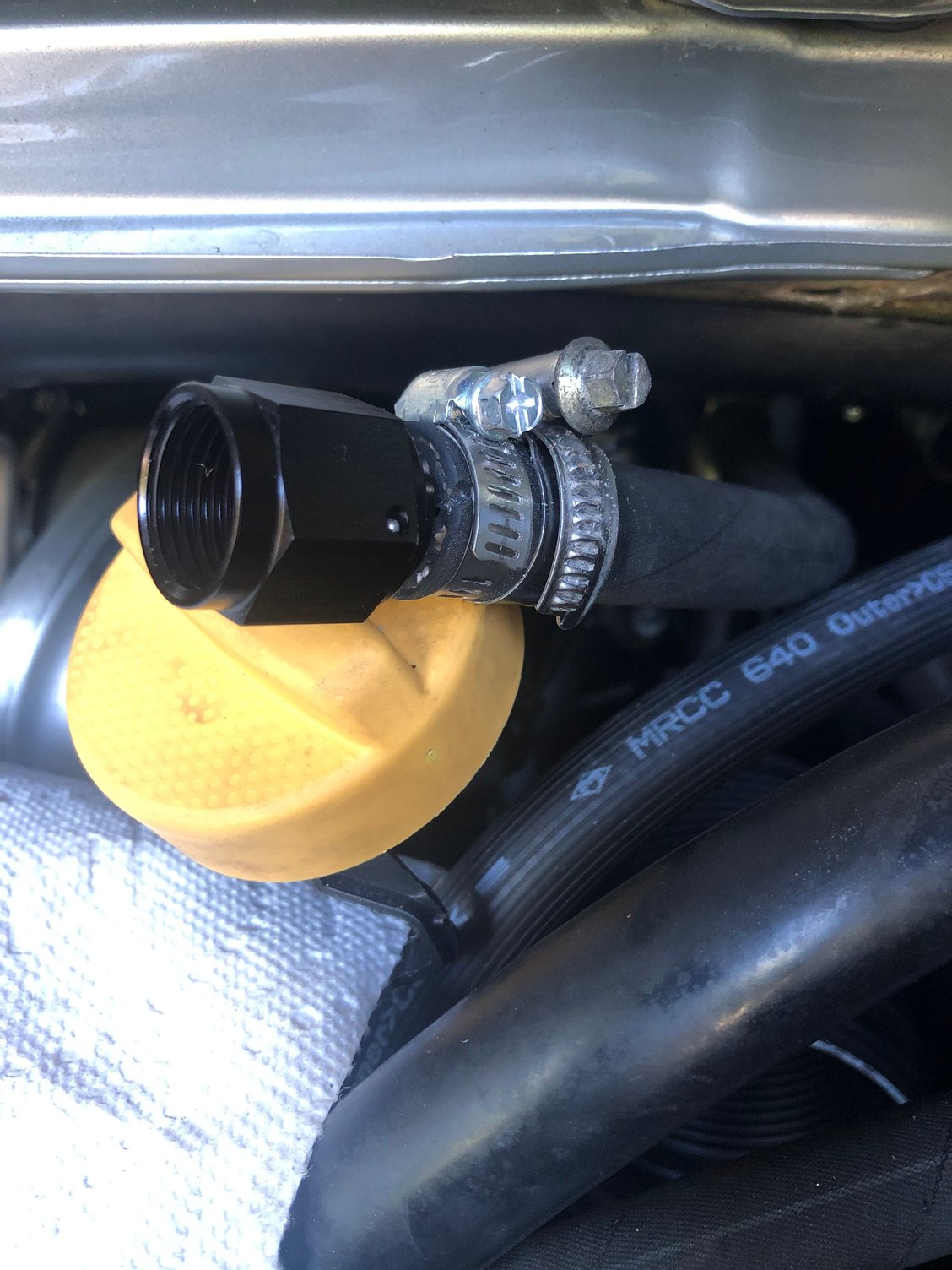

The hose end, dremelled off and replaced with the femail AN fitting:
The connection in the car and the leak stopped:
The fittings I used:

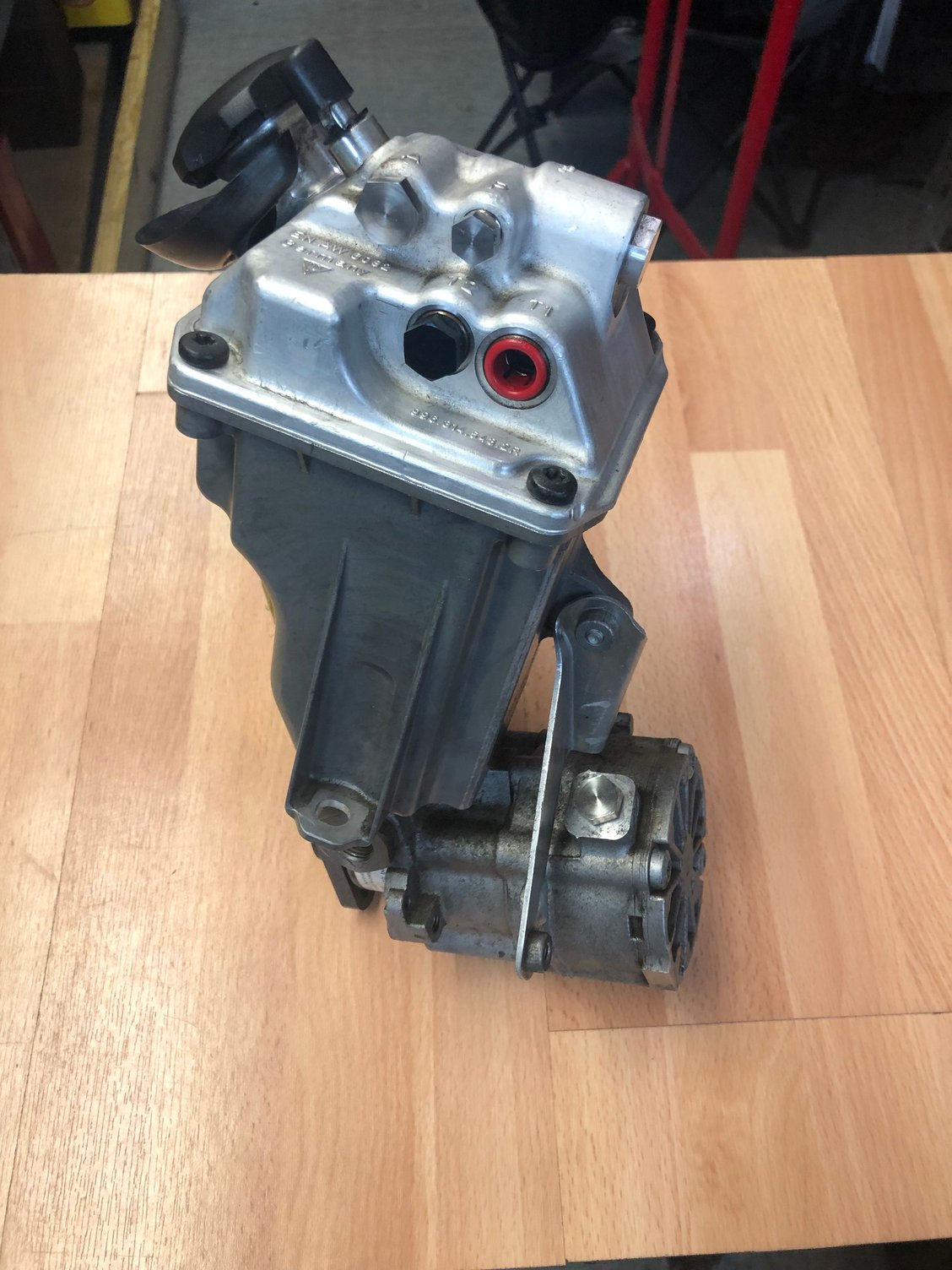

Both the last 2 options require you doing something about the PS pump. The pump is really 2 pumps,one for the PS rack and one for the slave. You either need to go to a GT2 PS Pump/Reservoir or pull the PS pump apart, remove the coupler and put it back together hoping it does not leak since I do not believe the flat O ring between the halves is sold by anyone that I found. If you pair the GT2 pump with the 997TT reservoir to avoid the cost of GT2 reservoir, you still have to plug the reservoir for the lines that no longer will be used.
The "easiest" solution in situ, in my opinion having done the work before with the engine out, would be the EVOMS kit with a GT2 PS Pump/Reservoir. You may still have an issue with the PS rack return line, but you can do what I did if needed. This was you do not have to drill/tap, split the pump and remove the coupler nor deal with plugging the pump/reservoir. The only thing that is not clear on their website is if there are any mods needed to the bracket to work with a 997 since the trans case is different than the 996, where they originally developed the kit.
