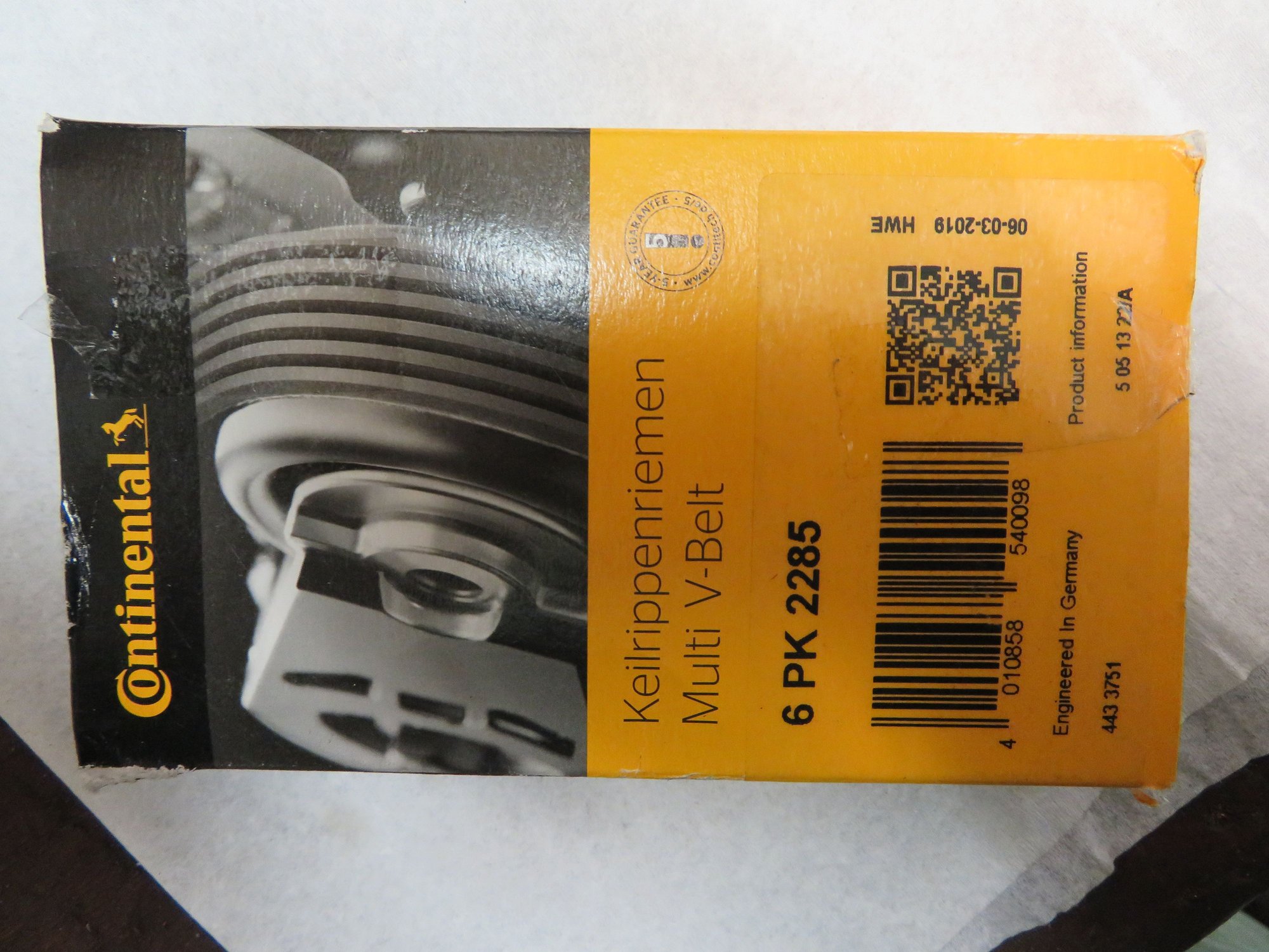

Unfortunately, I shredded my serpentine belt at the track the other day and it took the part number on the belt with it...I'm trying to find the right belt for the 997tt but for Continental, some parts suppliers have it listed as 2112mm (which I'm guessing is a common error and this is the Carrera belt?) and some places have it listed as 2285mm (a 6pk2285 belt) and the 996tt is listed as 2288mm (I was under the impression these used the same belt as the 997tt but might be wrong here). Any one know the right one?

Here you are.
997 Turbo mk1 belt.
Regards
Hans

Perfect thank you!! So it is the 2285mm belt
