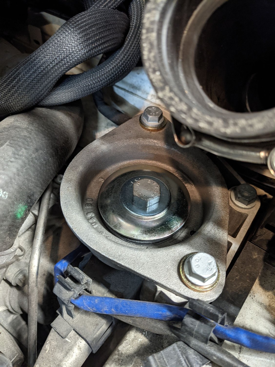

These were just put on my car but I'm wondering if from the top they look correct? Ive read on the 996tt forum that the small gold washers where the bolt mounts to the chassis ARE NOT to be used. Any help would be great from anyone who knows.

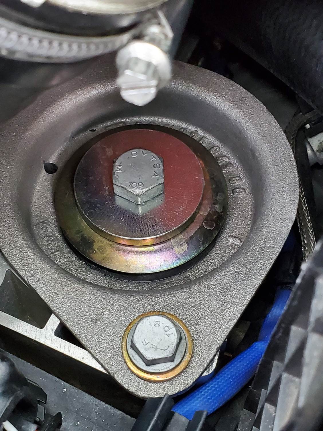

Looks fine to me. I have the same gold washers to the chassis on mine. What's the harm of using them? The center washer should/could probably be a bit larger and slightly thicker - part# 99902512401 but as long as the large concave washer doesn't bend, it should be fine also.

Small washer needs to be used otherwise the bolt head bends the big washer
