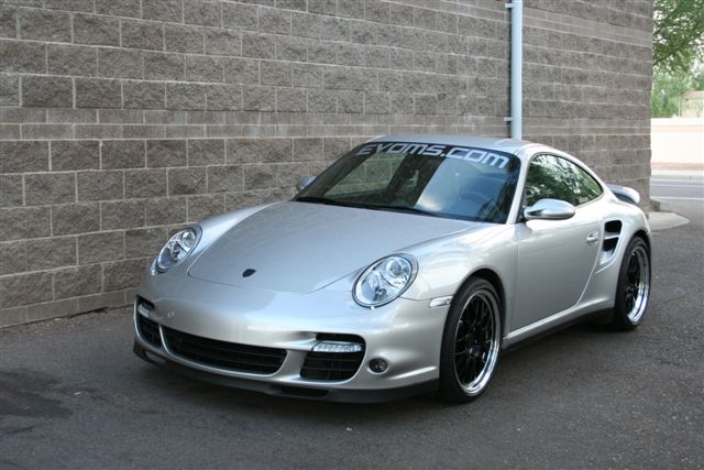

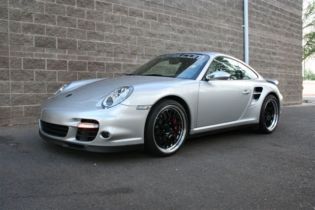

I know yesterday we were talking about the stage 1 upgrade but yesterday we added some new shoes to the new beast. Thought I would share the new look. These are 19" Fikse Profil 10, polished lips, black centers. 11.5 x 19 and 8.5 x 19. Let me know what you guys think.
We chose these wheels after building a set for the white 996TT "DMK" that is featured on our site. I like the look of the step lip. Most all 3-pc wheels these days have a flat lip and I wanted something different. IMHO the step lip looks tougher and is much stronger than the flat lip. Additionally, these wheels are fairly light at only 21.5 pounds front and 23 pounds in the rear each.
Anyone interested in the stock wheels, let me know.

Looks great!
For comparison, what do the stock wheels weigh, and do the TPMS sensors attach to the Fikses ?

Wow that's an amazing look right there, it just needs to be SLAMMED I love Fikse's, and most of all step lip wheels

23 and 28 I think
