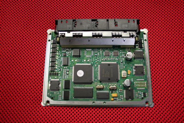

Here are some photos of the "brain" of the 997TT. We are working on the computer as we speak. Those of you who are familiar with these computers, it looks nothing like the 996TT ECU. Additionally there is a separate controller that is not pictured that is also part of the engine functions.

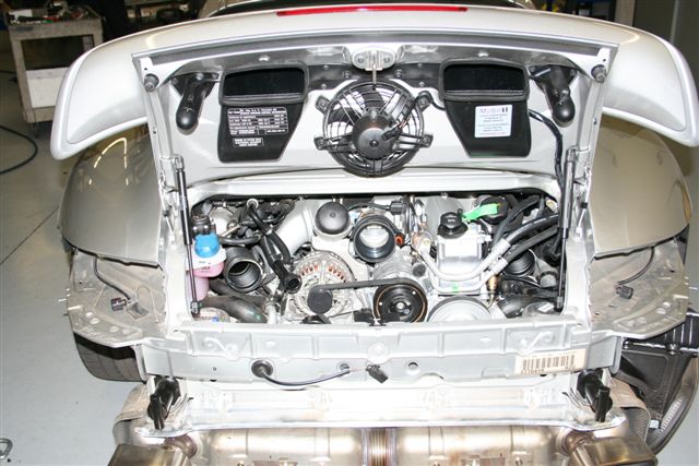

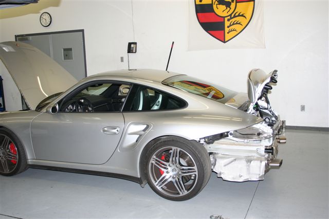

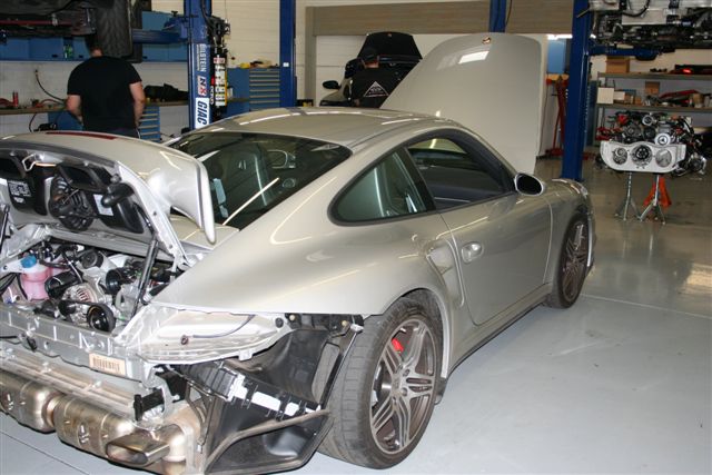

Evolution MotorSports Is a GOD !Evolution MotorSports Is a GOD !Evolution MotorSports Is a GOD !Evolution MotorSports Is a GOD !Evolution MotorSports Is a GOD !Evolution MotorSports Is a GOD !Evolution MotorSports Is a GOD !Evolution MotorSports Is a GOD !Evolution MotorSports Is a GOD !Evolution MotorSports Is a GOD !Evolution MotorSports Is a GOD !
It appears that we will begin dyno testing next week. We started digging into the car a bit this week and we have some work to do before we begin testing. Porsche has made some major changes to the entire engine. The main components are the same but the top end, fuel system, intake, etc are all new. We have also been working with GIAC on the software which has been a work in progress. We will have more to add shortly.
Haha, amazing to see this car alreayd stripped apart, cannot wait to see what you guys have in store
