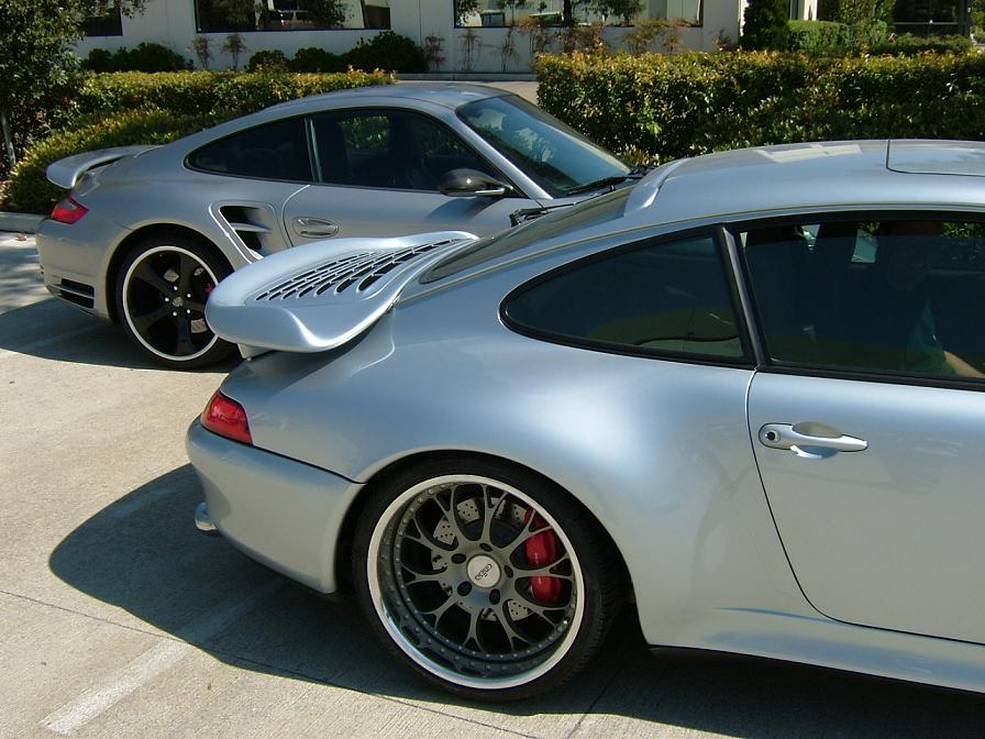

Today I almost had a really good photo opportunity since we had a silver 993TT, a silver 996TT and of course a silver 997TT. The only problem was the 996TT was/is a cab so all you have is a "911 turbo Evolution-type" photo minus the 996TT instead. Plus it was about 150 degrees out there today so parden the lack of quality....
