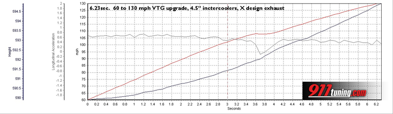

Through the month of February we are offering our power kit bundle(997.1TT) for only $2995 which includes our 63.5mm compressor upgrade (good core required) and our custom tuning which includes 5 upgrades and comes with brake boosting for free.
If you purchase the bundle and add any of our X design exhausts you get a direct $1000 OFF retail. Furthermore, if you purchase our 4.5" race intercoolers you get an additional $600 OFF retail.
Markski
911tuning
6.23sec. 60 to 130 mph on the VTG upgrade, 4.5" race intercoolers, and our X design exhaust.

On your 6.23 60-130 can we have some more details as that is very nice number for such basic mods on the 997!
What fuel were you running?
Manual or tip?
Was there any weight loss?
What reduction of time do you think 100%meth would reduce that time by (if the run Was on pump)?

100 octane, 6 speed, very well driven, stock weight.
The car has the 65mm 7 blade VTG upgrades, our 4.5" race intercoolers, our X exhaust, fresh plugs,clutch, no boost leaks.

If your selling a 63,5mm VTG upgrade, why did you posted a 65mm VTG time?

Actually my mistake on previous post( at Starbucks working on 3 things at once ). We ran high 5.s best on the 65s( I have the graphs ). A client/ friend ran the 6.2 and a couple mid 6s. But the deal is on 63.5s.
Bit I can tell you that I have not seen much difference on the dyno between the two. A client in Kuwait put down 611rwhp on the 63.5s.
I have found that the exhaust side is too small on the vtgs so bigger the compressor wheel is it becomes counter productive. I would not go bigger then 65mm unless the turbos are from a gt2 with a larger hot side.
