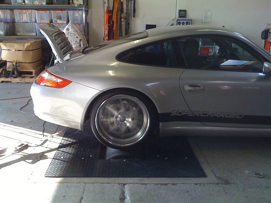

The independently owned 997S test car is fitted with AWE header/exhaust
All testing was performed on 91 octane on Dynojet 224LXC
stock is 314 whp which equates to a little over 355 hp at the flywheel (matches Porsche's advertised power)
supercharged stage 1+ produced 455 whp with 5.3 psi which is approx 540 hp at the flywheel. Thus represents a 185 hp gain.
The VF-Engineering new Stage1+ (one-plus) is a technical upgrade to the existing stage 1 which has been on the market for just under 3 years. Stage 1+ release will shortly be announced combining the GIAC "Flashloader" with all the options for race gas, valet and kill modes. Race gas dynos coming soon.

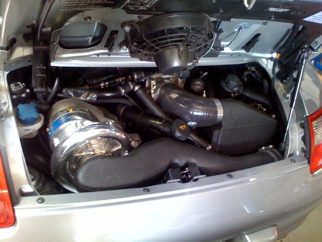

Delius,
A few questions if you don't mind.
#1. The VF-Engineering advertisement states the compression ratio as 11.3.1 in both the stock 997S and stage 1. Wouldn't the compression ratio be higher when using forced air?
#2. The Stage 1+ is stated to have approximately 540 HP at the flywheel using 91 Octane and 5.3 PSI. How is this different from the stage 1 using 91 Octane and approximately the same boost but the advertised numbers are closer to 470 HP?
#3. Will the GIAC coding be reworked to reflect the larger injectors so the computer MPG and miles to go until empty will be accurate?
FYI- I also have the stage 1 on my C4S and am very happy but do have a suggestion.

Delius, there is a discrepancy in the horsepower figures you provided. If you look at the ratios between rear wheel and crankshaft horsepower, they should be similar for both stock and modified motors. The ratios for stock don't look right, showing only 12% drivetrain loss. The supercharged ratio is 84%, which seems OK. Drivetrain losses of 16 to 17 percent are typically used for two wheel drive Porsches.
Stock 997S cars have often been reported to have 295 to 315 rear wheel horsepower. 355 stock HP with 17% loss factor equals 295 rwhp. The "before" test here may have included the headers & mufflers or the stock engine was putting out around 370 crankshaft horsepower. 10 to 15 horsepower is reasonable for aftermarket headers & mufflers.
Also, a 10 to 15 horsepower margin of error in dyno testing, depending on all sorts of factors, is common. This is not an exact science and has considerable variability. Comparisons should be on the same machine and carefully corrected for local conditions. Due to the adaptive ECU, multiple runs are needed, until the car doesn't make more power. Large fans blowing into the radiators and intake are needed for repeatability.
Using the same hypothetical loss factors, it looks like this car is making over 400 foot-pounds of torque. More torque than stock maximum from 2700 rpm. This looks like real world improvements.
The claim of 540 crankshaft horsepower may be realistic, given a 16% loss factor. The owner should replace the catalytic converters with aftermarket parts and run it again; catalytics should make another 10 horsepower. An IPD plenum may also provide midrange improvements.
