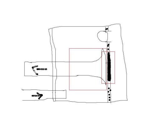

I purchased a set of stainless headers off of ebay - $150
Took my mufflers to a muffler shop, plasma cutted them open, took some parts out and then rewelded it back together - $50
And a set of used fabspeed tips -$400
Couldn't be happier with the sound and appearance. Feels like it pulls a bit stronger in the top end too. Then again my car is in the shop for a blown motor right now....but I highly doubt the exhaust changes are the cause.
The inside of the C2 (non-S) muffler is pretty empty with the exception of a perforated wall.
Attached is a really bad MS paint drawing I did to show the internals of the muffler and what I took out of it.
The inlet pipe stops shortly after entering the muffler, and the exit pipe is setup like a funnel facing a solid wall within the muffler. Otherwise there isn't much going on inside the muffler. I put a red box around what I removed inside the box. I had the exit pipe cut back a bit and removed a solid section of wall that seperates the sound deadening chamber (which appears to be hollow) with the primary chamber.

I don't know if I could be as adventurous as you are, but would you recommend just any muffler shops or one that do routinely perform Porsche tuning!

I actually had to try about 6-7 mufflers shops before I found one that had the right tools (plasma cutter) and the confidence to be able to take on the project. I took the mufflers off of the car first, which wasn't tricky to do, instead of driving the car to the shop. The place that did the work was an independent shop in the middle of a small town in Texas.
For peace of mind I purchased a used set of 997 mufflers off of ebay ($100) just incase the shop destroyed the mufflers...
