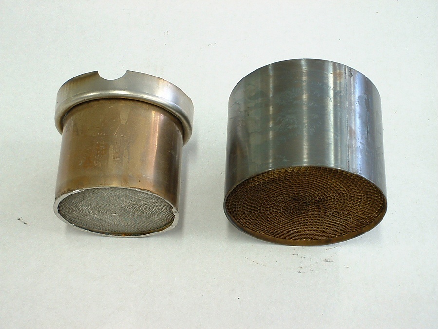

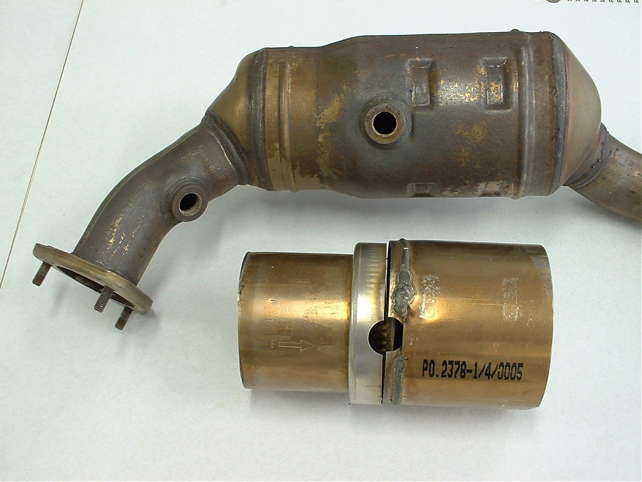

According to Europipe thier sport cats won't fit my 3.6L engine because the diameter and the position of thier tubes are different compared to the 997 3.8L.
The stock 997 or 997S exhaust uses two pairs of 400 cell cats and replacing these with big size high quality 100 cell sport cats is the way to go.
400 cells = 400 cpsi = 400 cells per square inch = 20 x 20 cells
100 cells = 10 x 10 cells per square inch = less backpressure = good
Checkout the 400cell against the 100cell. It seems that the cats are a choke point for the exhaust system using the OEM cats.
