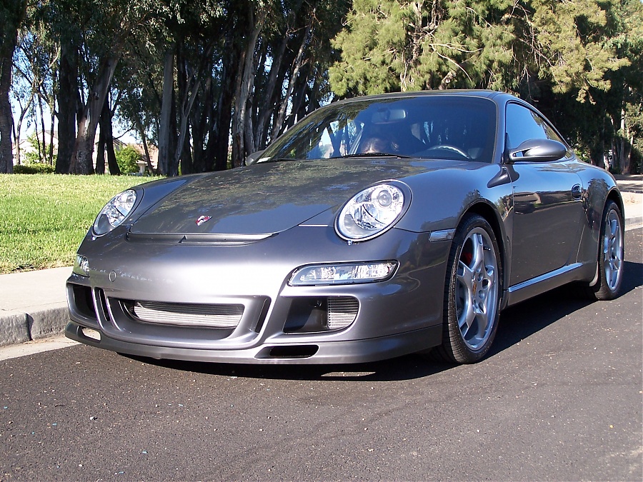

Just do it.....it's very doable, just need to drive careful. Have it wrapped in plastic and be prepared to replace your lower lip. No biggie IMO...the look is worth it:

As I told you on the PM my GT3 front is 4" of the ground that is with Bilstein PSS Coil-Over System. If you look at Synergy see above picture with H&R drop, his GT3 front is 3" of the ground. It's not a every day driving car for sure, but it's a best front end Porsche ever make!
