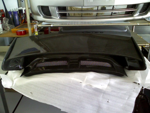

GT3 wing on C2S
I'm selling this GT3 997 Wing. You don't need to modify fan location and fitment is guarrantee. Carbon Fiber decklid and wing. This mfg in Germany.See attached pic.
Price? do you only have one?
