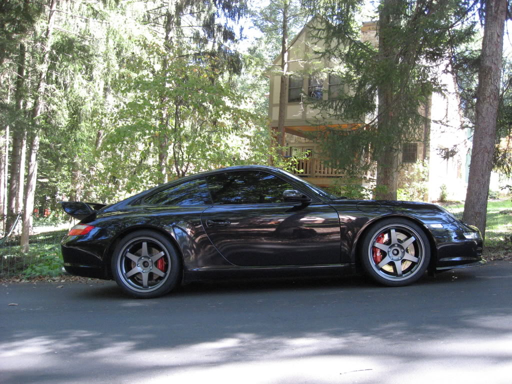

I went with the HUGE Brembos instead of going ceramic. I would assume that they are heavy, but they stop like crazy from 160mph (like on the main straight at VIR into turn 1 hairpin). They refuse to fade too, with race pads and race fluid. I like 'em. Just a mention. Also, since you're talking the 'look' of a yellow caliper being a positive, consider the look of the Brembo 15" 6 piston for less money. Just a thought... Note: These wheels are 19", for perspective, and I only have them on the front.
I have driven both...but only own one...that said, I like the steel rotors as I can use cup rotors that are half the cost for tracking and they are very predictable in their wear and expense needs. Also, when really being beaten on...anything can break...I would rather just pay less for the replacements. That said, resale-wise...PCCBs are a pretty big boon to the price of any car equipped with them...so financially in that regard they are better.
Thank you. I think they're pretty dope too. I really am pleased with them, and I LOVE walking up to the car when the light is hitting them like in the pic.
Old Guy, if you are talking about my wheels, they are Volk TE-37s, and are actually relatively cheap... and really really (like Champion really) light. Good track wheel.
