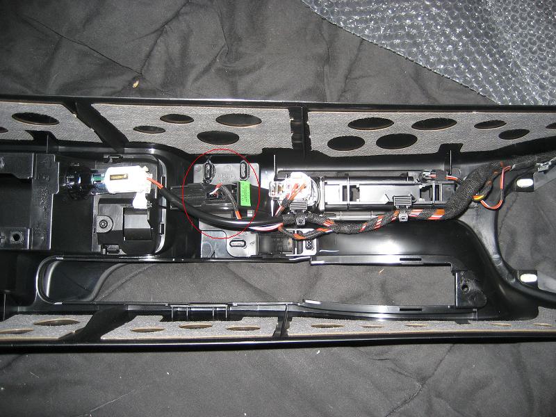

Looks like I learned something new about 997's the hard way.. Do not put your key in the ignition with the center console removed / unplugged. It set off the airbag light. Good times.. Good thing I have Durametric

yup yup.. there's some type of sensor circuit in the console. when i swapped mine out, i disconnected that battery you should always disconnect the battery when taking anything electrical apart.

Yup, i did the same thing when i painted my center console, had to go to dealer to do the quick clear

I forgot to plug the wire back in and had the same problem last time I pulled the console.. that's why I've got the durametric now too
