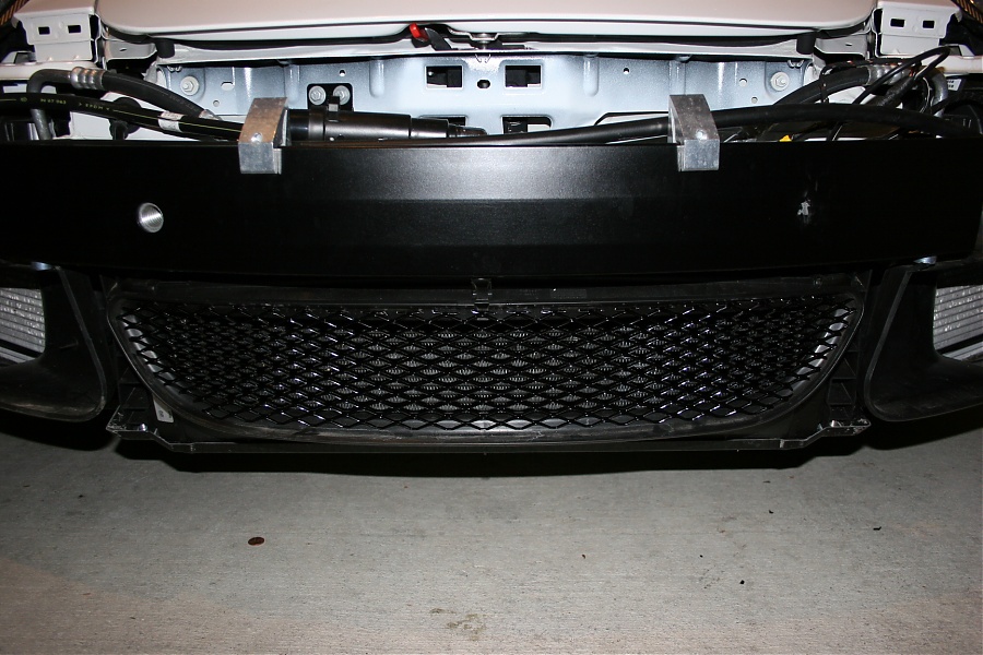

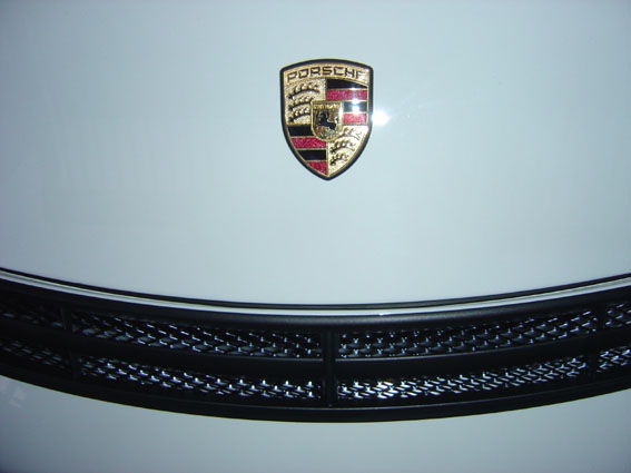

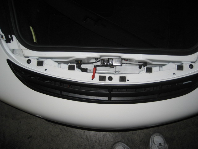

here's a few pictures where the top of the bumper meets the hood. the bumper actually is supported by the chasis. i'll look for a picture of the buttom of the inside of the bumper. i know i have one somewhere
