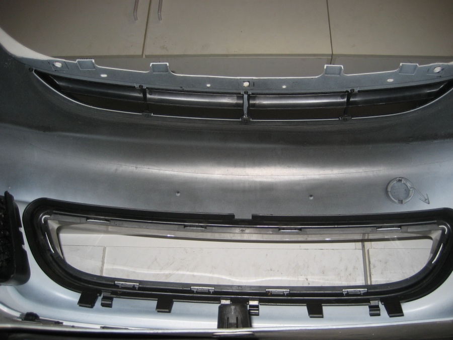

Besides the Cayman site DIY stuff, does someone have the GT parts manual pics that show the parts blowup of the front bumper cover?

sorry for the delay guys.. i'll try to have the pictures of the back side of the gt3 bumper showing the smiley face

Groovy. Got car, got the vent/grill... now just need to know when to start cutin' into the bumper cover.. and what to do about support on the back. I might end up with the same 'wire clip' solution as is posted on the Cayman DIY on the subject, but I'd like to see how the factory designs the solution, and the dealer just won't pull the bumper cover off of the GT3 for me to take pictures. Go figure.

minok, so far were still scheduled to install the grilles on my buddy's gt3 bumper. i'll take pictures for you ASAP. sorry for the delay.

here are the pictures as promised. there seems to be an internal support system on the back side of the gt3 bumper smiley. but im sure it can be fabricated out of some plastic or aluminum. so from the back side, the smiley face is secured on to this internal support sytem.
