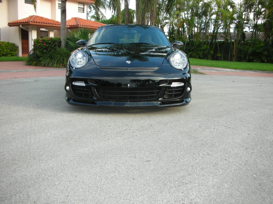

I lowered mine with Techart springs . It's less than 1 inch from stock but since mine is a Turbo the front spoiler is low . I use the stock settings and have no problems. I don't track the car though and would get the coil overs if I did.

2) Here's a front photo of how low my Turbo spoiler is in the Techart . You have no idea the effort I place into avoid scraping that painted lip .

interesting concept.. sounds abit like the low riders with air bellows lifts that can be used to bounce cars. Nice ride, I can imagine, I have trouble with my stock front end on curbs...that's mainly why I haven't lowered mine yet.
