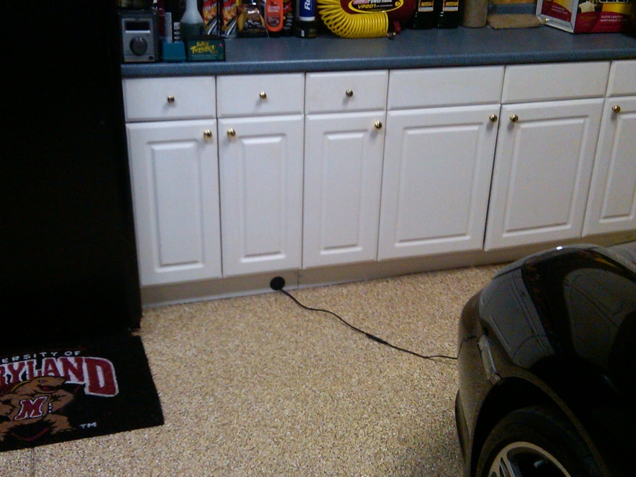

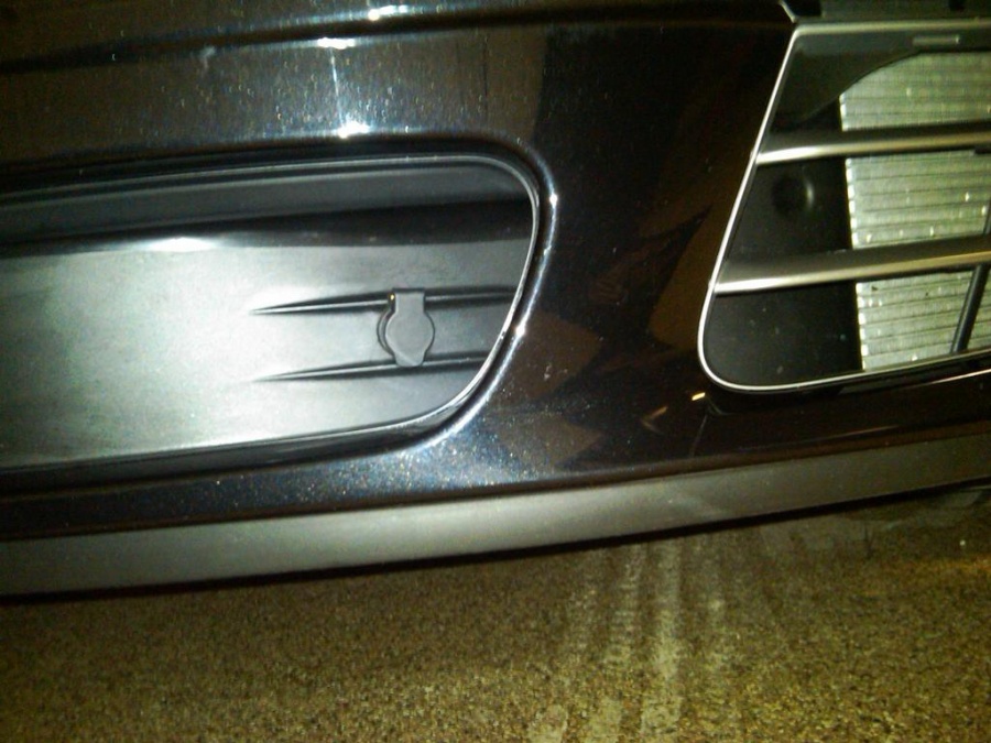

Why not just keep using the Battery Tender you have now ? I have used one on all my cars and motorcycles and wouldn't use anything else. Here's my setup. Hardwired a powerlet socket to the battery below the front bumper and just plug in !!!!!
