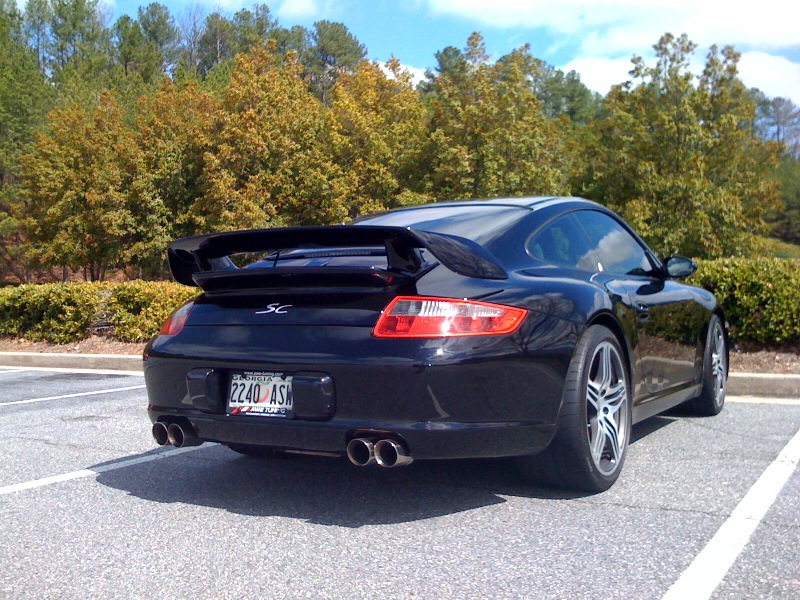

Sadly, it may not be enough. The paint under my original badge was deformed. Whatever, visible within 10 inches, not beyond that.
Regardless, there is only 1 way to fix it: install an SC badge, and with it gain 175 HP!
