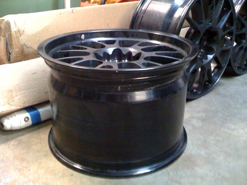

Originally Posted by AJ997S
Are you running 20's? Any pics?
18's
all go and no show, just wanted them light (23lbs rears) and wide, they are CCW for the track
Waiting on shaved r compound tires now

Beauties! Ya these are gonna be my 4th set. Never had 20's so I'm puttin' em on for show.
